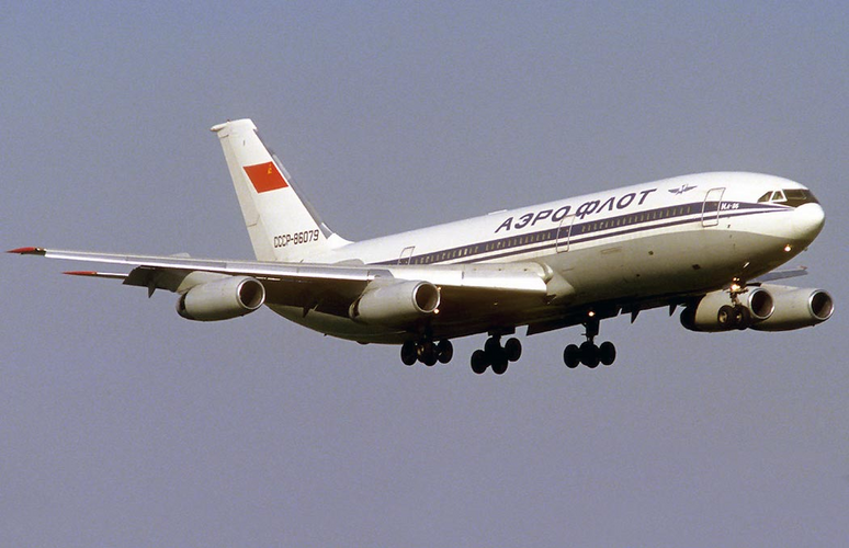

The Ilyushin Il-86 is a now forgotten (At least in the West) Soviet attempt to create an answer to Boeing's highly successful 747 series and maybe if the USSR had lasted a few years longer it might've done better.
Here are some stats from the Il-86 wikipedia article:
The Ilyushin Il-86 (Russian: Илью́шин Ил-86; NATO reporting name: Camber) is a short- to medium-range wide-body jet airliner that served as the USSR's first wide-bodied aircraft. Designed and tested by the Ilyushin design bureau in the 1970s, it was certified by the Soviet aircraft industry, manufactured and marketed by the USSR.
Developed during the rule of Leonid Brezhnev, the Il-86 was marked by the economic and technological stagnation of the era: it used engines more typical of the late 1960s, spent a decade in development, and failed to enter service in time for the Moscow Olympics, as was originally intended. The type was used by Aeroflot and successor post-Soviet airlines; only three of the total 106 constructed were exported.
At the beginning of 2012, only four Il-86s remained in service, all with the Russian Air Force. By the end of 2020 the number in active service was reduced to three.[2]
Specifications:
Crew
3–4 flightdeck, 11 service
Accommodation
320 (18F, 56J, 246Y) or 350Y
Freight
16.0 m3 (565 cu.ft)
Length
60.22 m (197 ft 7 in)
Height
15.67 m (51 ft 5 in)
Span
48.06 m (157 ft 8 in)
Wing
300 m2 (3,229 sq ft), 35° ¼ chord sweep, 7:1 AR
215 t (474,000 lb)
OEW
115–117.5 t (254,000–259,000 lb)
Payload capacity
40–42 t (88,000–93,000 lb)
Fuel capacity
86 t (190,000 lb)
Turbofans (4x)
Kuznetsov NK-86
Unit thrust
127.5 kN (28,665 lbf)
Cruise
Mach 0.782 – Mach 0.82 (831–871 km/h; 449–470 kn)
Range
5,000 km (2,700 nmi) (ICAO reserves, 300 pax)
Takeoff BFL (ISA)
2,800 m (9,190 ft)
Landing
1,200 m (3,940 ft)
Max. rate of climb
15 m/s (2,950 ft/min) (SL, 210 t (463,000 lb)
Fuel burn
12–14 t (26,000–31,000 lb) per hour

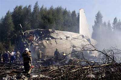

Hull losses: 4
Hull-loss accidents: 3 with a total of 14 fatalities
Criminal occurrences (hull-losses, excl. hijackings): 0 with a total of 0 fatalities
Hijackings: 1 with a total of 0 fatalities
Survival rate: 12.5% of all occupants survived fatal accidents (from a single accident where 14 of the 16 people lost their live)
