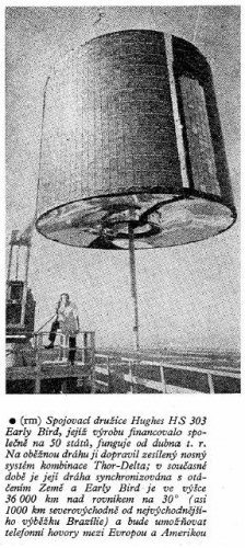

from L + K magazine,here is the Hughes HS-303.
Thanks. The Hughes HS-303 is, of course, also known as Intelsat-1, launched on 6 April 1965.
A derivative, known as HS-303A, was used for the four Intelsat 2 satellites launched on 26 October 1966, 11 January 1967, 23 March 1967 and 28 September 1967.
