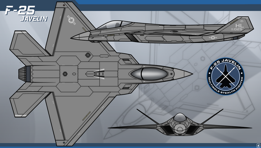

Has the US ever proposed and/or seriously considered making a lower-end single-engine fighter based on the F-22 to the style of Su-57/Checkmate?

There's also a relatively high lower size limit for a fighter that carries weapons internally.
For all practical purposes, the F35 is just above that lower size limit!
In terms of payload volume, the practical minimum size is 2x AMRAAMs and 1x 2000lb JDAM (convertible to 4x AMRAAMs for a pure AtA load). Will you usually carry that 2000lb JDAM? No. You'd usually be carrying a bunch of SDBs, exact number depending on bay volume (VTOLicious' design had 4-6x, my strongly suggested modification would have ended up with 8x due to how that bay worked). But some rare missions would require giving someone a BLU-109 bunker enema, or delivering 2000lbs of Official Displeasure to the local Bad Guys.
In practice, the KF21 is about the smallest you will find, and it's roughly the size of a Legacy Hornet.
Something Gripen sized is just too small to have a viable internal payload.

And that's the catch.
If you expect a plane to use your legacy weapons, you need a big freaking airframe, even for a single engine "lightweight fighter"
