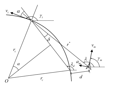

I've been trying to implement a trajectory controller for a fixed wing UAV to follow curved paths using this paper.
https://www.sciencedirect.com/science/article/abs/pii/S1270963818322971

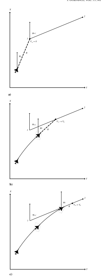

It uses a missile guidance approach called pure pursuit with a virtual target. Pure pursuit is a simple approach which means that the pursuer adjusts its course to face the target. Here for trajectory/path tracking, we use a point in the path as the virtual target with a minumum distance that has to be maintained between the pursuer and the target which means that the pursuer never reaches the target.
Source: https://www.researchgate.net/public...thm_for_Following_a_Desired_Flight_Trajectory
In the paper (https://www.sciencedirect.com/science/article/abs/pii/S1270963818322971) this strategy is implemented with one modification. Instead of looking at the line of sight (LOS) angle, we take the closest point to the path and look at the LOS angle between that point and the reference point and use this angle as the reference angle whcih is lambda d here.
One problem that I encountered here is that the initial conditions play a huge role in this strategy. If the initial heading angle error is too large or the UAV is too far away from the trajectory, it tends to not converge into the trajectory since it a reference course angle that points to one point of the path from another point instead of from the UAV.
As a possible solution, I am considering implementing another position controller, so that the UAV gets close to the reference trajectory and stays there.

I made it talk about GNC topics in general so it also includes guidance laws for AAMs and SAMs. Pure pursuit is an old guidance law but nowadays also used for trajectory control.
