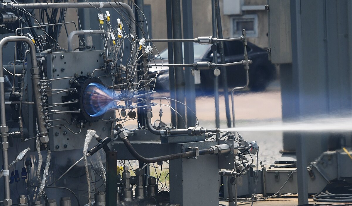

25% seems a decent amount.
https://en.wikipedia.org/wiki/Rotating_detonation_engine
Not for H2 and O2. RS-25 and RL10 are already near the maximum possible. And that is for all chemical rocket that don't use Florine or Beryllium (or other toxic substances)
You sure about that?
https://thephysicsofspacex.wordpress.com/wp-content/uploads/2016/07/isp-upper-limits.pdfhttps://ntrs.nasa.gov/api/citations/20210009939/downloads/Review of AM RDRE Injectors.pdf
The biggest improvement is with air-breathing performance though.
https://digitalcommons.unl.edu/cgi/viewcontent.cgi?article=1043&context=usafresearch
yes, because can't fix the losses like:
Where does the remaining energy go? Some is stored in the motion of the exhaust: in intramolecular vibrations and rotations, and kinetic energy in directions perpendicular to the rocket’s travel. Some is also used to heat (and boil) the two cryogenic liquids from their stored temperature to their combustion one (a quick estimate factoring in only latent heat of vaporisation of oxygen brings the upper bound down to 520s)."
also, to heat some LOX and LH2 into GOX and hot H2 to pressurize the External tank.
The point is that ISP can't improved enough to make a reusable SSTO with wings viable.

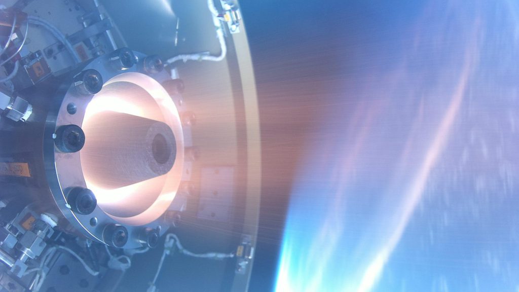

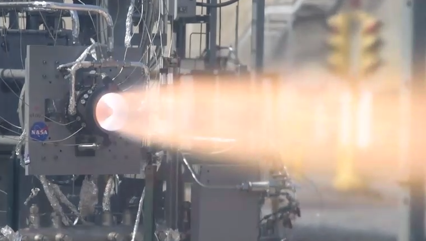

According to NASA the RDREs have 15% better Isp but the RDREs themselves are more compact, which reduces mass.
It is commonly cited that the peak benefit to detonative combustion devices is the promised ~15% boostin specific impulse (Isp) compared to the maximum theoretical Isp in an equivalent constant pressure (CP)combustor. However, other major performance characteristics are advantages with these engines ratherthan quantities such as Isp and thrust. For one, these engines are often much more compact allowing forreduced hardware mass a geometry. The completion of combustion has been shown to occur much fasterthan CP combustors and thus drastically reduces L* requirements as well as the potential to maximizecharacteristic velocity (C*) efficiency. Other works have suggested that these combustion devices couldproduce lower overall heat fluxes and lower total heat load to active cooling geometries. In addition, lessonslearned from the literature indicates that the heat flux curve in a detonative combustor may decrease as theflow gets closer to the chamber exit. This would allow for the design of ultra-low pressure drop integratedcoolant channels, which is another major performance advantage for this engine type. Each of theseperformance criteria make a strong case for investment into detonative combustion device technologies.
Then you have the possibility to use air-breathing RDE operation in atmosphere, where an Isp of 3,800-5500s can be achieved.
https://www.sciencedirect.com/science/article/abs/pii/S0360319915009842
I don't think we can rule out viability yet, but it may never be competitive for commercial space launch.
There's no way we could know that. Smaller engines mean smaller body around engines, both of which save massive weight, which means smaller wings, which saves more weight + reduced cooling weight + higher rocket Isp + massively higher air-breathing Isp. Lot of gains there.
Don't think we can even nearly rule out viability, but whether it will be commercially viable is another question.
yes, we can. The margins are so slim even for an expendable one. And no, it is not saving "massive" weight and hence not "lot of gains". A Raptor engine only weighs 3,500 lbs. It wouldn't be much smaller. More compact RDE is inches and not feet. The nozzle dominates the length of the engine, the combustion chamber is a fraction of it.
