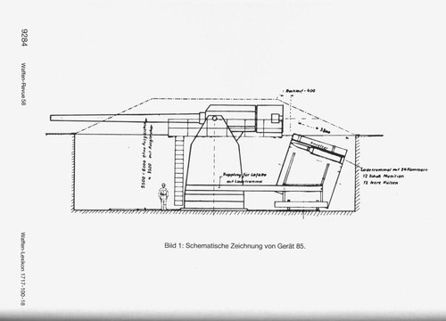

Do you know about this Skoda Gun's barrel length and design date? and if it's actually 240mm or as German practice 238mm?
I had a look into that issue of the Waffenrevue, mentioned there are two designs for a 24cm Flak.
"Gerät 80" for the Krupp design and "Gerät 85" for the Rheinmetall-Borsig design.
The design by Krupp is only mentioned, but not presented in detail, because knowledge about it was
sketchy at best, at least at the date of this publication.
For the "Gerät 85" the surviving data are shown, emphasizing the big challenge, an AA gun of that calibre
posed to the designers, mainly because separatopn of shell and propelling charge wasn't regarded as an
option, in order to achieve a reasonable rate of fire. With a kind of a revolver drum, holding 12 cartridges,
a rate of fire of 3 rounds per minute should be achieved. After 12 shots, the whole drum would have been
changed, probably no mean task, with a weight of around 350 kg for a single cartridge (weight of the shell
180 kg).
Nor is the true calibre mentioned, nor a design made by Skoda.
