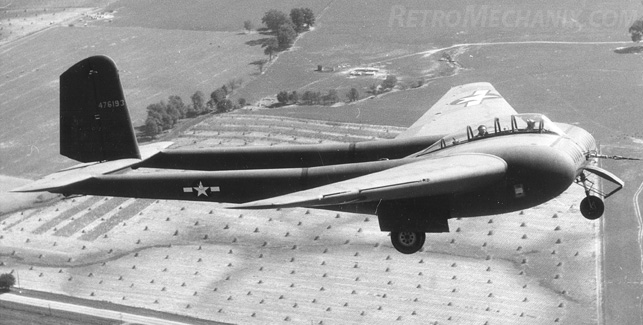

[font=verdana, sans-serif]Check out this article at RetroMechanix.com on the General Airborne Transport XCG-16, an American flying wing type combat glider with twin booms and a single rudder dating from 1944:
The article reproduces an Army Air Force preliminary evaluation report on the type, which features 21 high resolution photos of this innovative but ultimately unsuccessful aircraft.

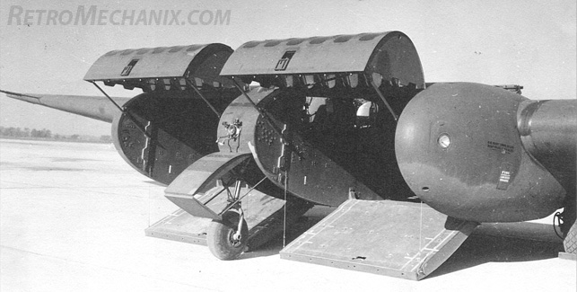

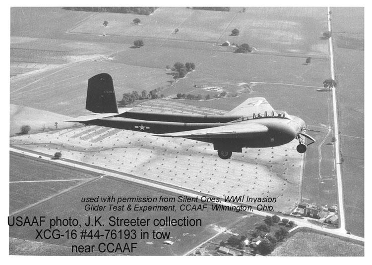

A second post on the XCG-16 has been added to RetroMechanix.com featuring an additional 17 photos of this unusual lifting fuselage military transport/assault glider:
The high resolution photos include some interesting shots of the glider being towed by a B-17.

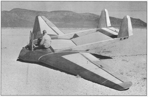

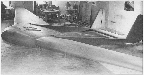

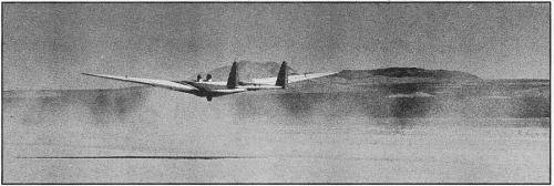

Here are the images and relevant text from the above :-

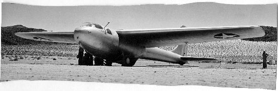

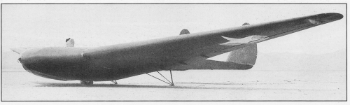

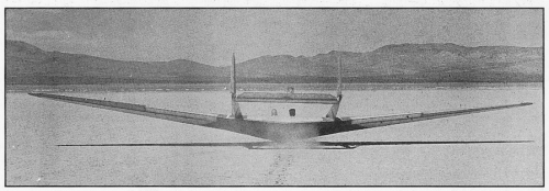

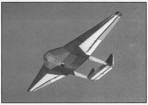

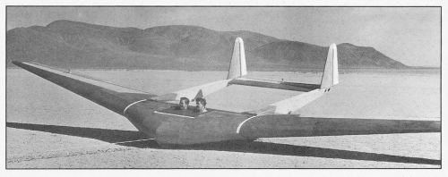

"At around the same time Bowlus began work on a twin-boom flying-wing glider for military transport work. In order to test his design he began work on half-scale proof-of-concept flying model, forming the Airborne Transport Company in Los Angeles, California for the purpose. Construction of the test model was carried out in his tiny shop, a former dry cleaning shop where there was just sufficient room to build the two-seat open-cockpit prototype. On completion. the glider was flown at Muruc Dry Lake, now the site of Edwards AFB. The glider flew well and
Bowlus and partner Albert Criz set about designing, building and marketing the full-size glider, the XCG-16."

So if I'm not mistaken, there were three separate designs (although the MC- designations are often different depending on the sources):
  • Bowlus MC-1, the scaled-down glider seen in the above photos.
  • General Airborne MC-2 (Sept. 43), a twin-boom 42-place flying-wing cargo glider. XCG-16-GA (not built).
  • General Airborne MC-1A (1944), a 14-place cargo glider, two built as XCG-16A-GA (44-76193 and ?). Scaled-down version of above.
What I haven't been able to determine is if the second XCG-16A did exist or not.

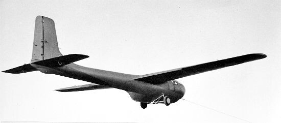

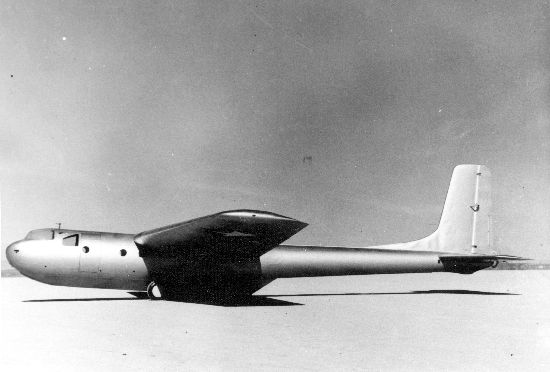

Color 1943 test flight footage of the Hawley Bowlus and Albert Criz designed Airborne and General MC-1 (NX-21757) and the subsequent General Airborne Transport XCG-16A (USAAF Ser. No. 44-76193) transport gliders has recently been posted on YouTube by the Southern California Wing of the Commemorative Air Force (CAFSoCAL). CAFSoCAL describes the footage as 1943 test flights taking place at Oxnard Air Force Base, California (known today as Camarillo Airport (CMA / KCMA)) that was "donated to CAFSoCal museum along with the center section of the wind tunnel model of the aircraft."
YouTube - XCGS 16 Bowlus Glider Test Flights
Higher quality color footage of the General Airborne Transport XCG-16A (USAAF Ser. No. 44-76193) posted on YouTube by Periscope Film. The film is described, "This fascinating, silent 16mm movie comes from the estate of William Hawley Bowlus (May 8, 1896 - August 27, 1967) or someone who was close to him."
YouTube - Periscope Film "WWII FLIGHT TESTS OF XCG-16 CARGO GLIDER DESIGNED BY HAWLEY BOWLUS 28754"

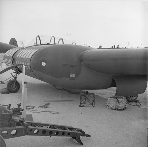

Hi!

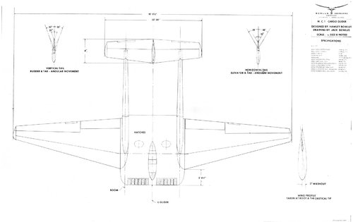

Awesome, Robin! Hadn't seen these before.

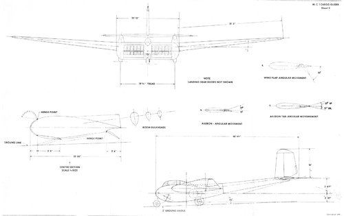

Is a drawing of the MC.2 possible ?
