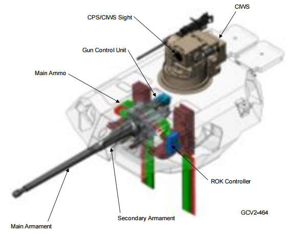

I wonder why they jump right from the 30mm to the 50mm SuperShot? No consideration towards the 40mm SuperShot, conventional 35mm, or 40mm CTA?
beleive in Janes IDR there was also a 55mm Supershot proposed, but yes each rd would take up quite a bit of space.
Actually, isn't the supershot round the same length and width but without the taper?
It might displace more air, but I don't think it's going to cut down on ammo capacity to any real degree.
I do have a question about the supershot.
In addition to the ADFSDS round, is there a full caliber explosive round for this weapon? Without one it would seem to be a one trick pony that's less versatile than the 35mm it replaces.
There is a 50mm Programmable Airbursting Munition round (a scaled-up AHEAD) as well as the sabot. I've not seen a pure HE round, but it's hard to imagine that one would not be made.

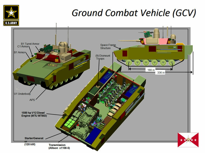

GCV will be a.............rebuilt Bradley?
http://breakingdefense.com/2016/10/rebuilding-the-m2-bradley/
Yeah, just as "rebuild" as some helicopters.
"More horsepower. Higher suspension. A blast-resistant underbody. Safer fuel tanks. A larger hull."
Basically they build an entire new hull with all new insides, and slap the old turret on.

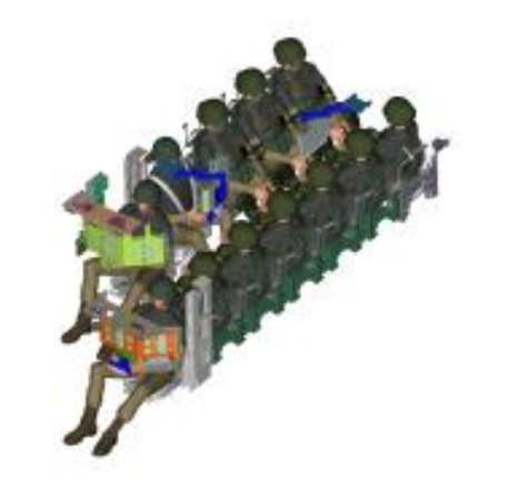

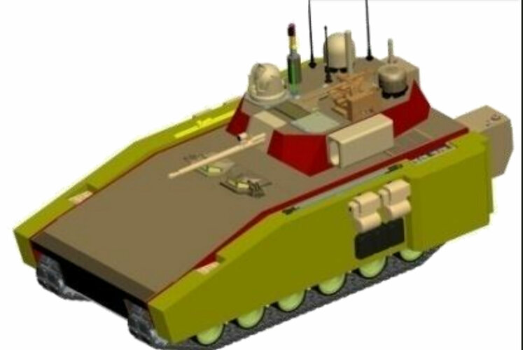

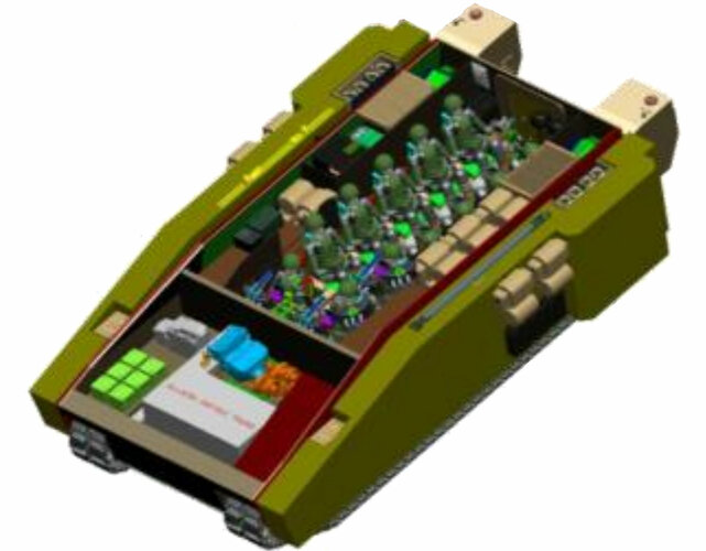

General Dynamics GCV proposal

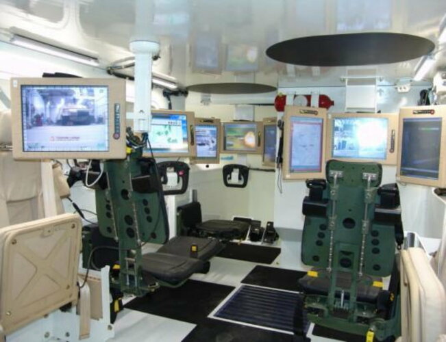

(inclusion of last pic, w photo of mockup interior - is my guess based on position and number of hatches, and similarities to render of crew and dismounts on 4th pic)
I'm still trying to find any drawings of it, or any other renders - unsuccessfully, so far.

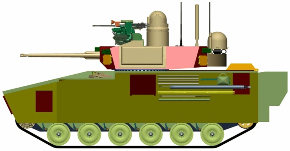

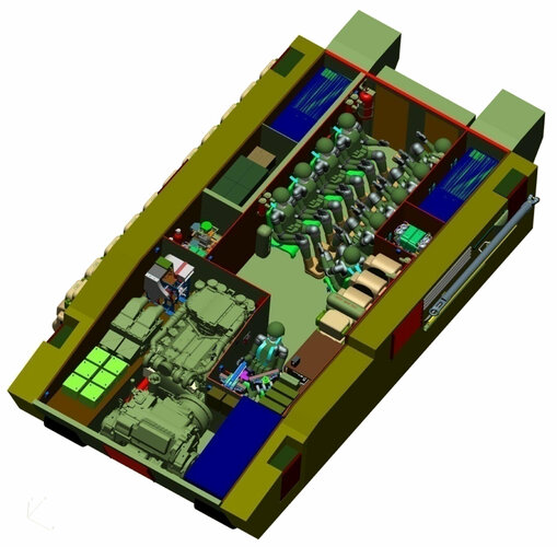

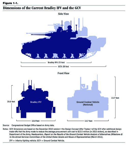

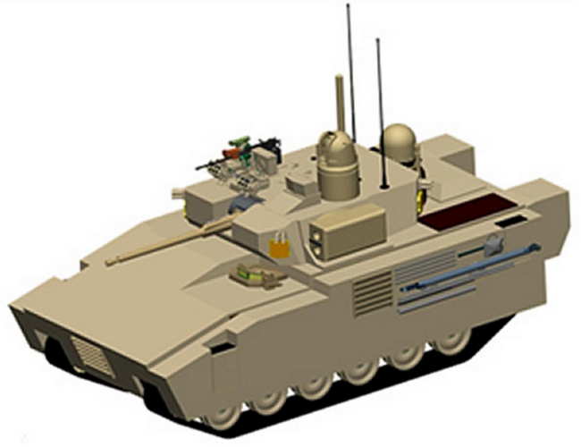

Notional design, one of several, and most illustrated

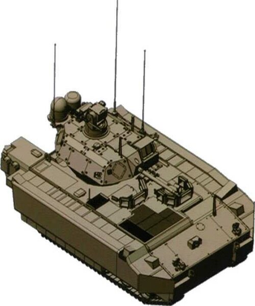

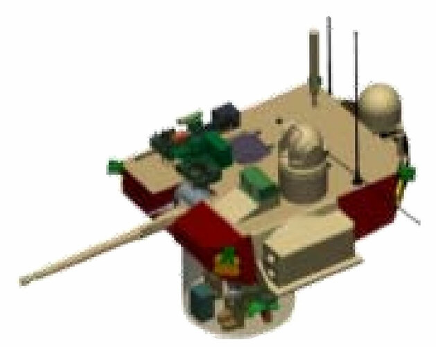

another notional design, but this one is with unmanned turret

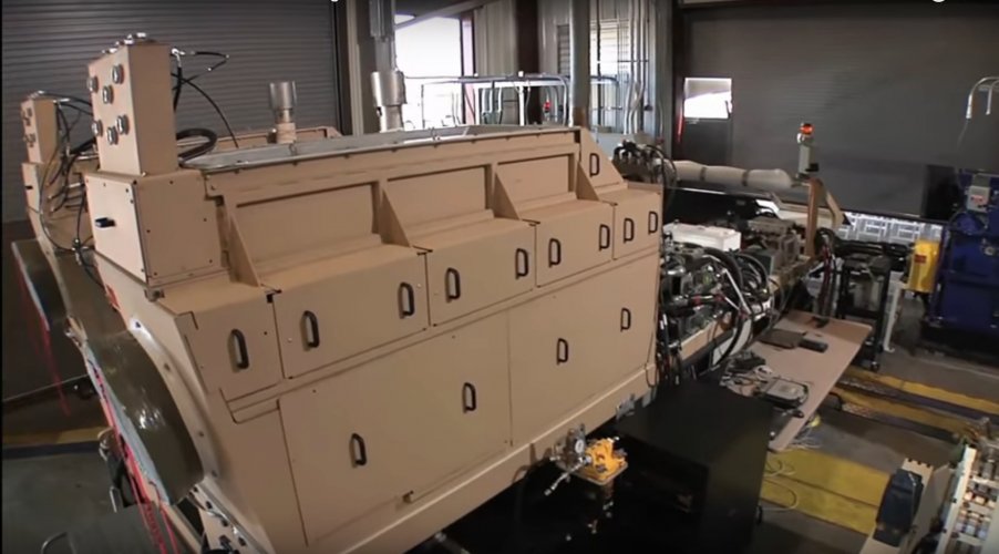

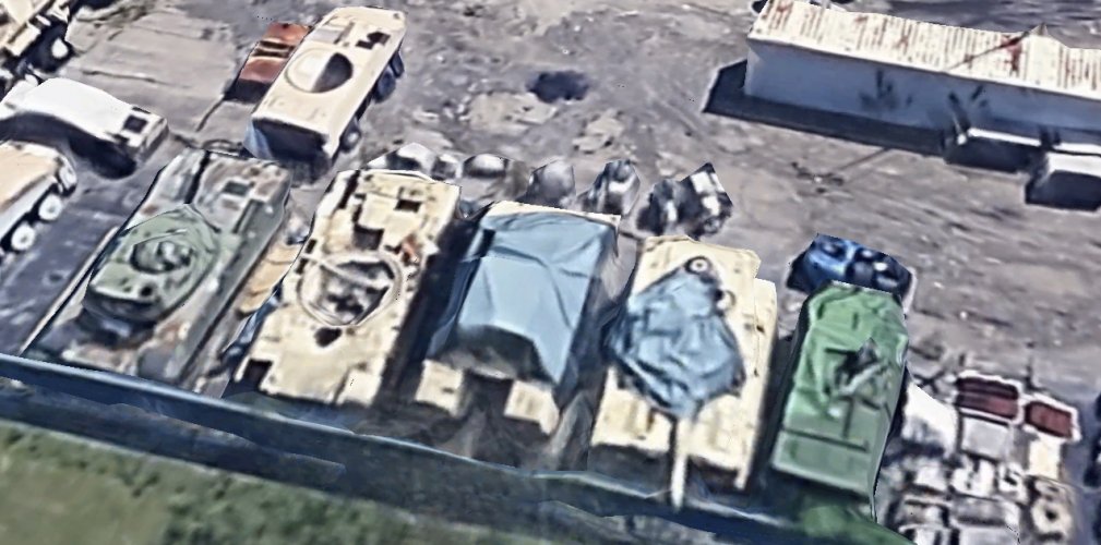

With turret fully covered by blue tarp, standing next to Abrams tank hull (in the backyard of GDLS headquarters in Sterling Heights, MI), and with large box-like structures mounted on the left and right sides of the rear exit,
one Damian Ratka have identified it, (or at least posted about it on tank-net forums and other places), as a prototype of GDLS-led team's proposal for GCV program.
Also, this pic was posted, with previously unknown to me image of the same version of GCV in top-left corner:
