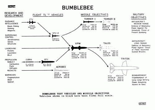

A very interesting diagram showing the evolution of the BUMBLEBEE program:

Triton would have been quite the impressive beast had they ever built it. Talos on steroids, and then some!!
Makes you wonder what sort of performance you would get out of a Talos-sized missile today.

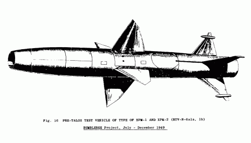

And here's a picture showing the general configuration of the XPM test vehicles:
It's called Brahmos. ;) (Of course it could have been Fasthawk. . . )
