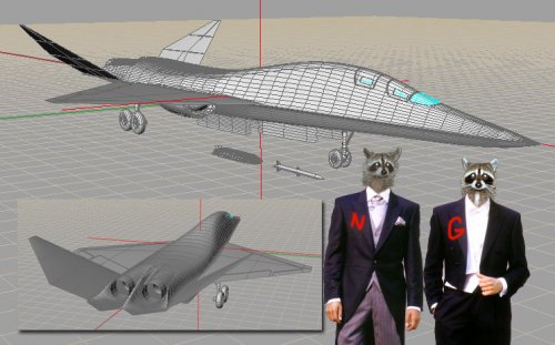

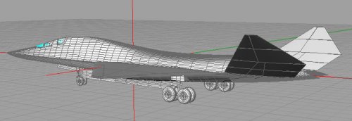

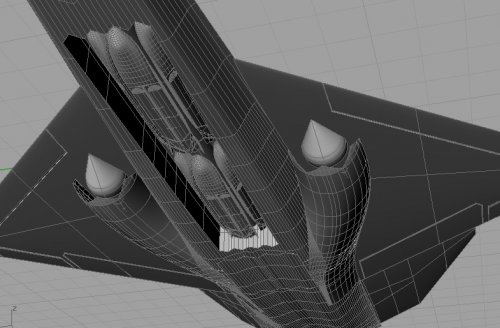

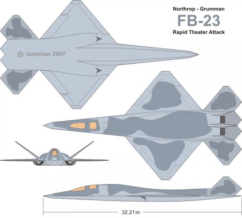

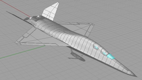

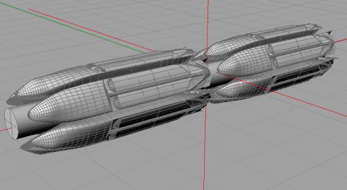

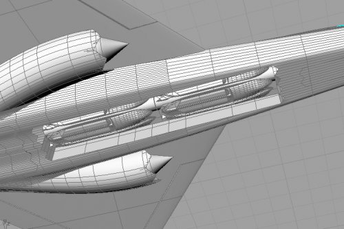

I just wanted to ask Joseph to reconsider the weapons bay size for the following reasons:

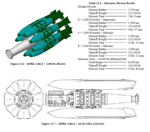

1. Comparing it to YF-23 design, it makes sense to have one big bay (8 JASSM) at the center and one smaller forward bay for the AMRAAMs. It just feels like TOO much weight in front of the CG with that payload. I am not sure the aircraft can rotate on take off

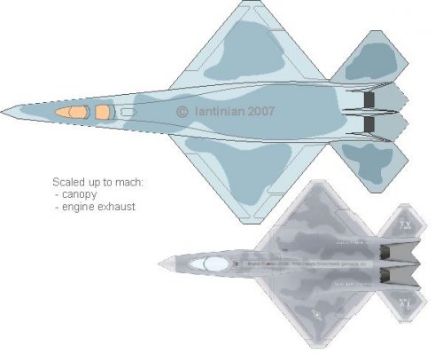

2. Comparing it to the Vendetta student design, it is understandable that Northrop will come up with a better aircraft for the same requirements. I think that extra expertise is in the form of lower RCS, longer range, higher speed (Mach 2+) and an extra smaller weapons bay.
3. Comparing it to the latest FB-22 proposal, the F/B-23 is a faster reponce version with better LO and longer range, but not twice the payload in my opinion.
4. Right now the payload is similar to the B-1B typical internal payload (the 3rd rear bay usually carring fuel). Yet the F/B-23 should not be that far behind in range. At almost 1/2 the Bone size, I don't see that as realistic.
