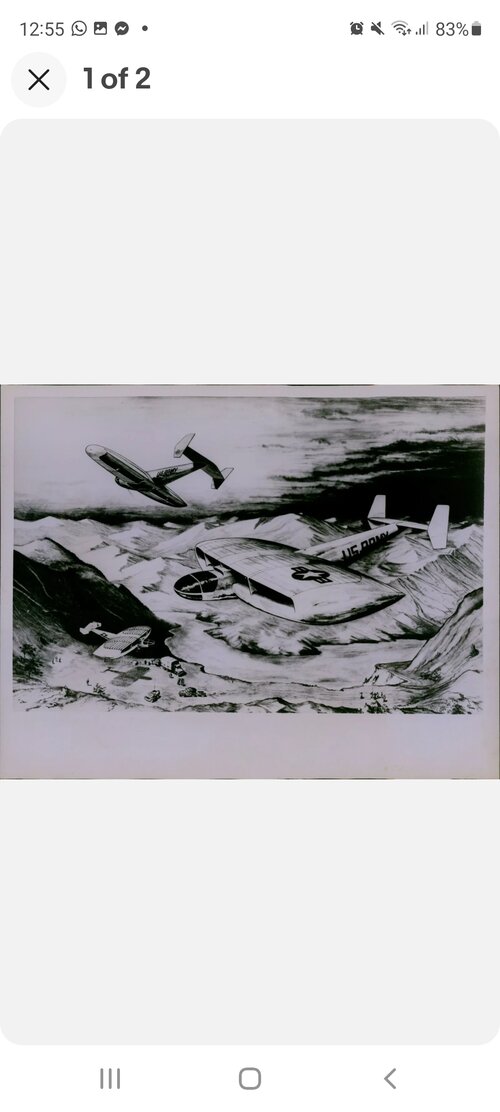

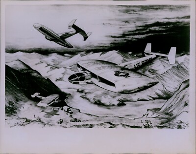

And the Lockheed "Omega" cargo lifter of the late '70's/early '80's used a transverse fan embedded in the wing for lift and propulsion:

That Lockheed Omega is new to me...and interesting. Any more information on the concept or a patent?
Thanks!

Re: Fanwing concept flight model (and a language question... Gaelic?)

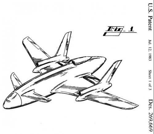

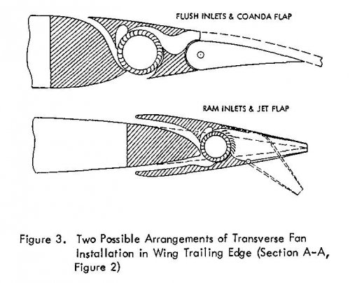

The aircraft configuration was granted a design patent. I've not found any propulsion system patents, but I haven;t really looked. A few AIAA papers, though.
Test of a high efficiency transverse fan
HANCOCK, J. P., Lockheed-Georgia Co., Marietta, Ga.
AIAA-1980-1243
Advanced Civil Military Aircraft - Technical feasibility assessment
BROWN, S. L., USAF, Wright Aeronautical Laboratories, Wright-Patterson AFB, OH; ESTILL, G. T., USAF, Wright Aeronautical Laboratories, Wright-Patterson AFB, OH
AIAA-1983-1592

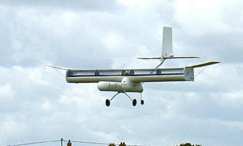

Re the fan wing, I saw it fly at one of the Parc Aberporth UAS events some years ago. I can't comment on efficiency etc but it certainly did STOL OK and appeared to be adequately controllable. It was only an early prototype so maybe this isn't a fair criticism but one area that I felt did let them down somewhat was the quality of their engineering.

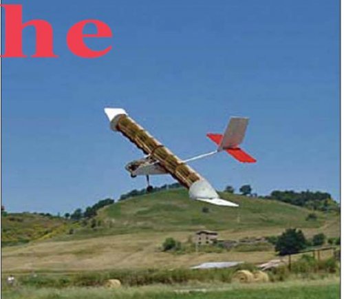

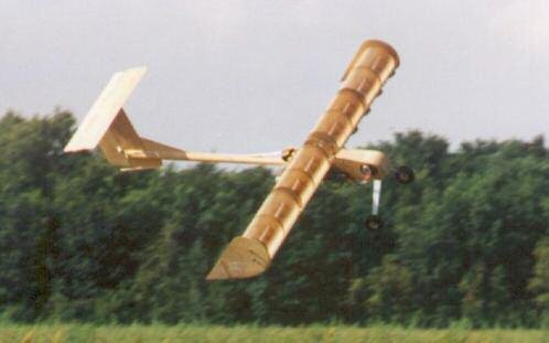

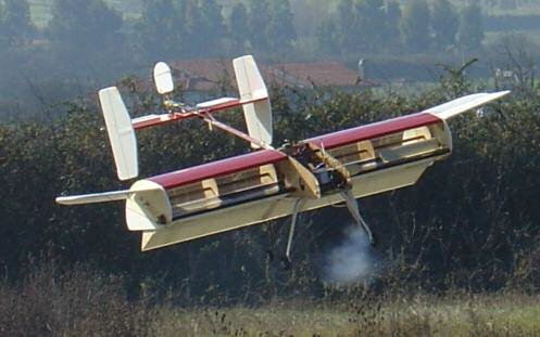

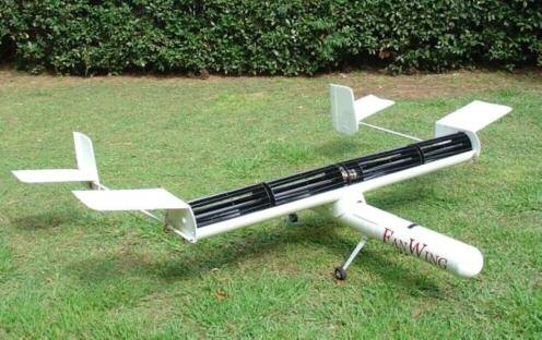

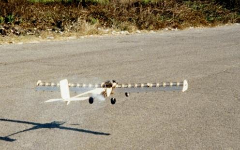

Some pictures of the FanWing flying test models, from a company document:

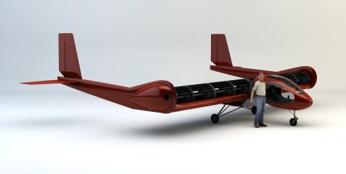

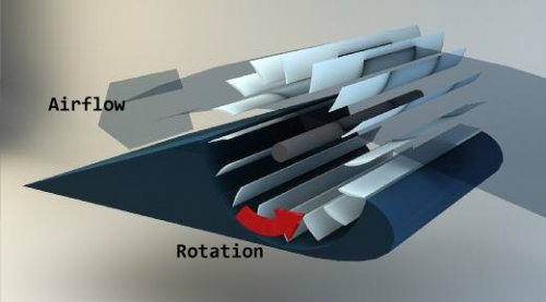

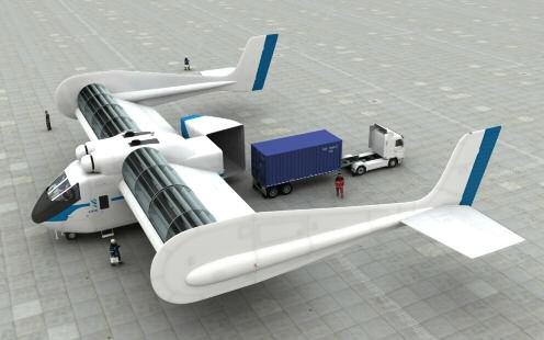

Future applications of the FanWing system on manned aircraft, from the same document:
I think the Fan-Wing concept is particular enough to keep it separated from the more generic Cyclogyros.
The answer may lay in Tridents post from 19th of March 2009. The Cyclogyros uses articulated
rotor blades, whereas those in the fanwing generally seems to be fixed.
yeah, assuming you used one engine per side. I guess if you used a single engine to power both wing fans, then you would maintain symmetrical conditions no matter what (even in the event of engine failure, at which point there is no asymmetry but no lift either!)
"The FanWing has two engines for redundancy. One engine can keep the aircraft in the air and give it the power to climb. But if the worst happens pilots can autorotate down with a glide ratio of about 3:1. Peebles likes to say the FanWing is similar to a helicopter but with a much simpler drive train."

BTW I understand they're are just a draft for a presentation, but I was wondering about the engine in the Cargo Lift project, they look to me a some kind of jet but I don't see any exhaust.
The engines exhaust is at the top of the center pod that houses them. You can see the two exahusts in the images quite clearly.

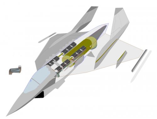

Would it be possible to:
1.- thrust-wise, tilt wings leading-edge upwards to create a VTOL aircraft?
2.- based on this fan-art from user Planeman (a brilliant and very prolific graphics artist) elsewhere in the ´net, Would a concept like this generate sufficient power to lift a small fighter?
Edit:
3.- Is D-Dalus also practicable? I mean, I see in these concepts no "duct-loss" like other V/Stol concepts, but I worry about the volume of cold air needed to provide lift
Note: Mods, if this post is more appropriate for other topic, please feel free to move it, since I believe I am mixin fan wing with fan-in-wing and fan-in-fuselage concepts
It seems unlikely. Note that in the "official" renderings, the fan-in-wing system is *huge* compared to an equivalent conventional propeller, turbofan or turboprop system. So it would seem that the thrust per *size* of the fan is fairly small.
