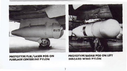

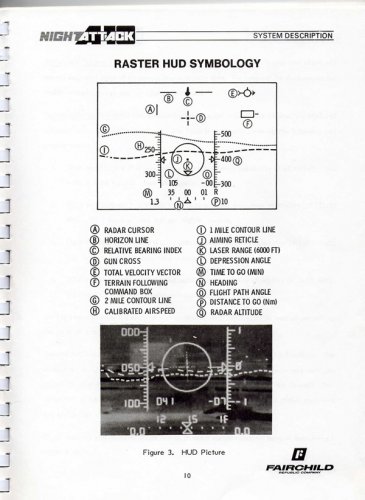

Interesting link. I've attached the various scans from Fairchild press releases and brochure.

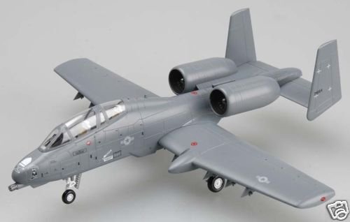

I was in my local hobby shop and found what looks to be a nice, assembled, painted 1:72 version of the NAWs A-10B. I found it here on eBay:
eBay won't let me grab the image, and I cannot find another picture of the model on the net. I have not looked at it closely for accuracy, and unfortunately it does not come with any weapons. But it seems like a decent model. (I paid $38, but you can get it via eBay for $28 if you're willing to order from Beijing.)
Here's the image...
Based on the photo, the model looks pretty nice. The images that I've seen of the real aircraft rarely show much in the way of ordnance...

I'll take a picture of my model and post it here. The overall quality is pretty good for a 1:72 scale. The cockpit is painted (no pilots, however). The only real question I have is the accuracy of the markings, but they seem good. It has an owl under an umbrella on the nose, which is apparent in at least one photo of the plane. The registry number (31664) is also correct. The nameplate on the base only says "A-10," not this specific version. There are a number of stores positions under the wing, but the lack of any ordnance at all is distracting--Hogs should have bombs.
From what I can tell, it's a pretty accurate depiction of the aircraft. Considering that my ability to make models that are not all covered in glue is nonexistent, this is by far the best quality model of this plane that I'm going to be able to get.
I don't think the designation "A-10B" was ever official. All my books on the Warthog refer to it as the N/AW A-10A.
