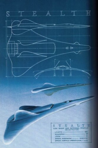

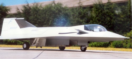

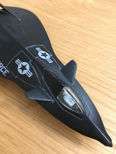

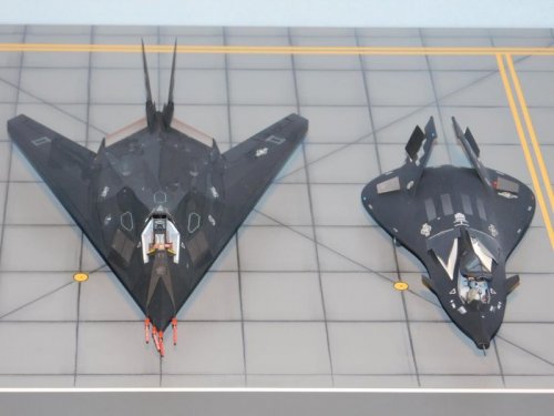

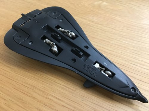

Very Nice buildup of the 72nd snaptite. It's too bad that Monogram had to butcher the beautiful LORAL concept artwork with the chintzy F/A-18 MLG and misproportioned belly (effectively turning the jet from a low wing monoplane to a midwing design, like turning an F-20 into an F-16) but from the top, the jet is still very impressive, as your beautiful replica shows.

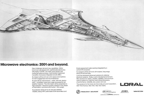

The real issue here is that the LORAL design is for a very high altitude wave rider with elements of XB-70 theory in it whereas the nominal 'F-19' was part of a fictional (?) COSIRS or Covert Survivable In-Weather Reconnaissance Strike system capability which simply never would have looked like the jet shown.
You don't build a huge wing area to fly 'In Weather' but /over it/ (turbulence etc.) and once you develop that concept and marry it to the ideals of stealth for which a blended wing:body theory, similar to the B-2, is applied, the nature of the design becomes one of a flat belly with a sculpted upper deck where the real depth of the structural volume (sufficient for OUTBOARD positioning of tall landing gear for instance) is inherent to a delta wing with F-4 rather than F/A-18 influence MLG.
The Monogram kits (they also did one in 48th with the full gear) diverge from this by attempting to navalize the aircraft with folding wings and other nonsense at a time when the SOA in VLO design was the F-117 with 'vinyl tile' appliques and lots of 'butter' edge seal putty that would simply never stand up to such articulation.
As such, rather than use what we now know to be a standard of design with the perfect skin envelope built first and the structural body integrated into it as a separately trimmed design, Monogram used a component approach with discrete fuselage and wing elements that could not and did not have the blended depth needed to achieve true VLO within a believable packaging constraint for such a broad-but-shallow design.

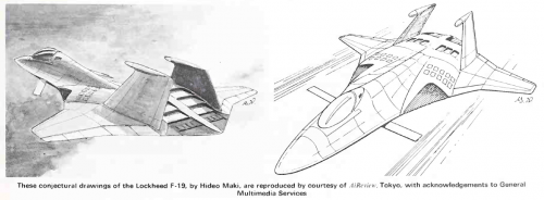

Part of this may well have been LORALs fault in putting what is essentially an F-16 scaled cockpit on what would have been something closer in size to an SR-71 but it is equally important to note that the LORAL concept artwork was only ever released once, as a (high) in-flight shot and thus you never really see the belly or landing gear.
