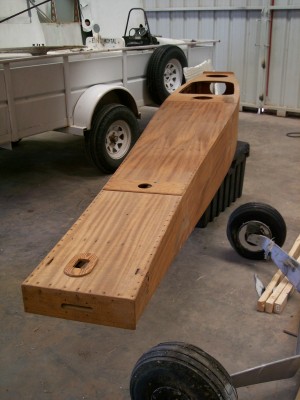

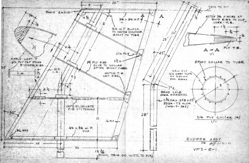

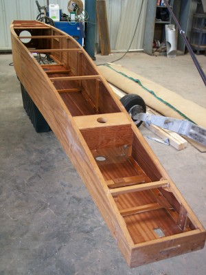

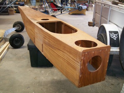

I am a longtime fan of the Volksplane VP-1 and VP-2 homebuilt aircraft by Convair engineer W.S. "Bud" Evans. I recently learned of the existence of an unfinished project by Evans himself for the VP-3: apparently a sleeker, cantilever-wing successor to the original strut-braced, single-seat VP-1. Plans and photos of the unfinished fuselage are visible here: https://groups.yahoo.com/neo/groups/VP-3info/info (members only) and I am in touch with the current owner of the project, Fritz Wagoner. Does anyone know anything more about the genesis of the VP-3? My usual sources have come up empty. Cheers, Matthew

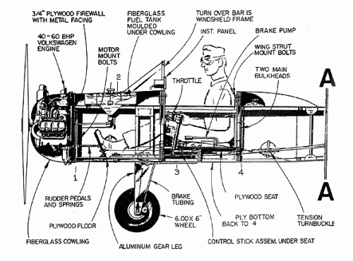

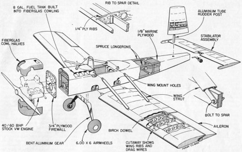

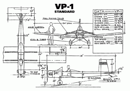

Just so that people have a rough idea of what the aircraft might have looked like, I'm attaching images of the VP-1's structure, basically similar to the VP-3's.
