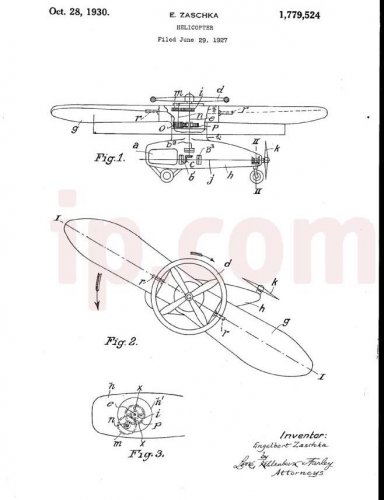

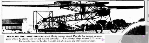

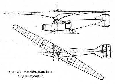

Thanks for reminding us to this nearly forgotten inventor. Zaschka filed a patent for a combined helicopter/
autogyro, using a rotor, where each blade was fitted with a gyroscope (dotted circles in the drawing posted
by hesham). So I wouldn't agree to the description "fitted with two rotors" from Wikipedia.

You are right my dear Jemiba,
and it seemed to be,that designer had many drawings and patents to a helicopter
designs.

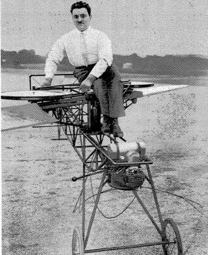

Not only "paper-warfare", but he actually cut metal !

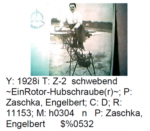

Found in AHS Journal N°6 1957, this photo of Mr. Zaschka on an aircraft, weighing only 95 kg (210 lbs) and
fitted with an engine of just 300 cc.
The gyroscopes on each blade are recognisable, I think. Judging the size and those cables on the ground,
seemingly attached to the aircraft, maybe this was just a model ("proof-of-concept-demonstrator" nowadays),
not a manned type ?

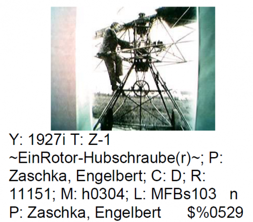

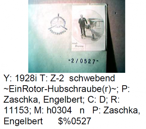

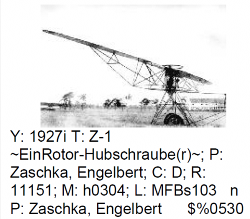

My dear Jemiba,
that's Zaschka Z-2,the early drawing in this topic was Z-3,and here is Z-1,page 56;
http://kulturserver-nds.de/home/hubtest/medien/Neg.Nr.GUN.pdf

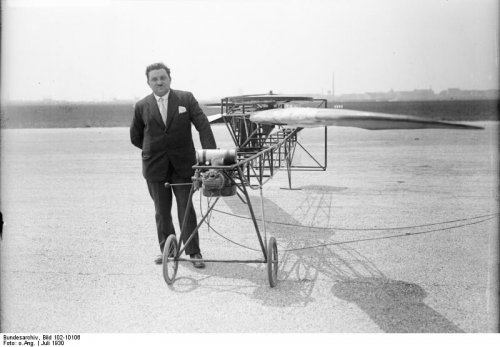

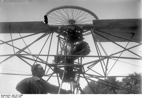

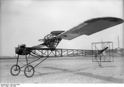

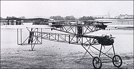

Hi, more photos:
source here: http://histaviation.com/zaschka_helicopter.html
  • Bundesarchiv_Bild_102-10105,_Berlin-Tempelhof,_Modell_eines_Kreisel-Flugzeuges.jpg
  • Bundesarchiv_Bild_102-10106,_Engelbert_Zaschka_mit_Modell_des_Kreisel-Flugzeugs.jpg

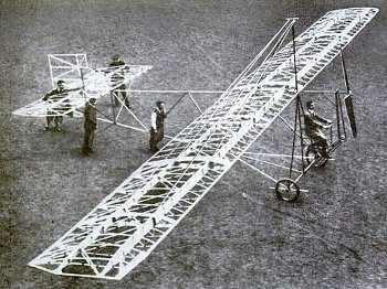

he also built a human-powered airplane in 1934.

What was the purpose of the gyroscopes in the rotating wing? Anybody an idea?
Re: Engelbert Zaschka Helicopter Project of 1928
FXXII said:
What was the purpose of the gyroscopes in the rotating wing? ....
The answer is in the patnet: "This invention relates to an improved helicopter in which the lifting propeller
and a gyrating fly-mass are continually connected with one another in rotation and can be coupled with the
driving propeller in order to drive it as a substitute for the motor if this latter should have got out of order
from any reason"
Thanks for the pointer.
But I don´t understand the mechanics. How are two gyroscopes coupled? They must be rotating in opposite directions, otherwise the precession will tip the aircraft to one side. Further, will a rotating gyroscope that is itself being moved in an arc in its plane of rotation continue in that circular movement? An engineering view would be most helpfull.
I have no idea, if this principle would have worked in reality, but the patent actually doesn't speak of
a gyroscope, but just of a fly-mass/flywheel-mass. I would interprete this as just a storage for energy,
that would allow the rotor a longer time to rotate after an engine failure. If the rotation of those masses
really would have increased the natural torque of the rotor, I don't know.
If a flywheel is meant for a rotor to keep turning after engine failure, then it must be attached to the rotor axle. A flywheel incorporated in the rotorblade itself would not transfer its energy to the rotation of the rotor.
So the mystery remains.... :p

Those gyroscopes could have fulfilled two roles: propulsion and stability.
If the gyroscopes were geared to the main rotor mast, their stored energy could help keep the main rotor spinning after the engine quits .... sort of a mechanical aid to auto-rotation.
Secondly, gyroscopes would stabilize the main rotor similar to the stabilizer bar on Bell 47.
Thanks for the Info.
