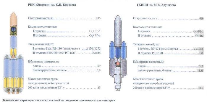

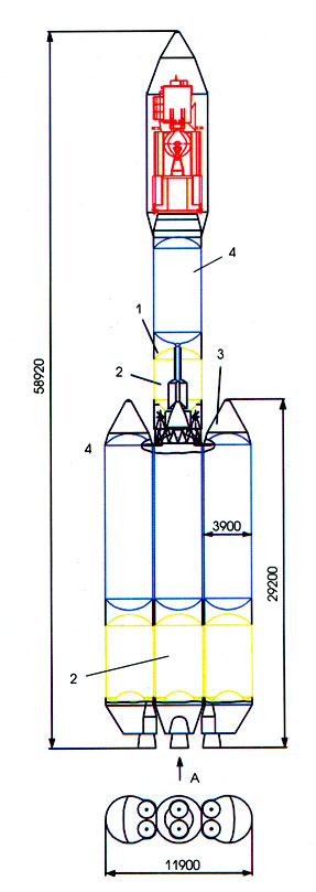

How would the Angara project have evolved if, instead of selecting the Khrunichev State Research and Production Space Center’s design, Russia had chosen RSC Energia’s GK-6/Energia-3 proposal?
This alternative rocket would have used three RD-180 engines—engines that were soon after selected for the American Atlas III rocket. This could have led to cooperation between Lockheed Martin and RSC Energia on developing the first stage for both launch vehicles. The design also utilized the Zenit launch pad infrastructure, meaning initial tests could have taken place at Baikonur, followed later by launches from Plesetsk once Pad 35 was completed. Subsequent launches could then have been conducted from Plesetsk.

Why does the image says that the Second stage uses O2+Kerozene when the RD-0146 is an hydrogen-oxygen engine (a Methane variant was tested but not kerozene, and as expander cycle engine kerozene is not viable).

Nevertheless the upper stage with its RD-0146 and new RD-451P vernier would still be difficult (Russia/USSR never had much luck with hydrogen stages), and there were concerns on Energia's capability to mass produce heavy launchers (ultimately Krunichev would have the same problem with the move of their factory from Moscow to Omsk), and also could Energia's proposal really use the Zenit pad? I know Khrunichev's first proposal could (and that's the reason for its design), but Energia's seem like it would require heavy modification like angara's (and ultimately it was concluded heavily modifying Plesetsk pad 35 was not necessarily the most economical choice)
