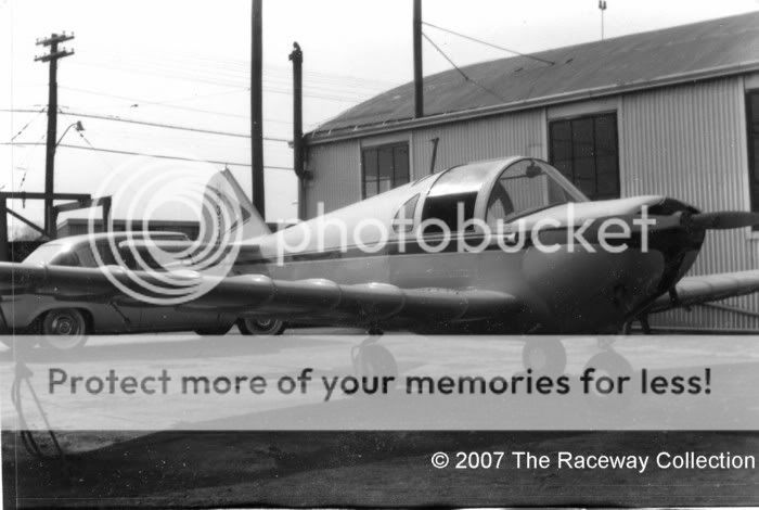

We owned one for about 30 years. I'll see if I can find a photo or two. It was supposed to be the last one or next to last one they built. When they gave up, there were still enough parts to assemble a few more, laying around in the storage building. I Let it go around 1993 (no damage, but had been sitting in back of the shop for decades-unflown, with the wings undeneath. I know I have some 16mm movie film I took of my Dad's first flight in it, trying to land at Flushing Airport NY, with a full tank of fuel. It dropped about 20 feet onto the runway, without damaging or bending a thing...Built like a brick-something or other...Some great manufacturing ideas..Left gear, right gear, and nose gear were all interchangeable. They slid into tubes. As you can see, there were no internal ribs. The ribs were external bulb extrusion. Strong enough that you could stand on outer wing without it flexing...Full length ailerons that I seem to recall, BOTH dropped to act as flaps, when you held both of the sticks together. Left elevator, right elevator and rudder were all interchangeable, (and VERY simple construction)with piano-hinge type mount. Left stabilzer, right stabilizer and fin were all interchangeable. Left and right wing were interchangeable. They could be bolted on or off in short time, as they were affixed to center section external butt rib wth a whole load of (I think they were 1/4") bolts & nuts. Easy disconnect of aileron cables etc. Great 125mph cruise speed on a 90 hp Continental. But the post WWII aircraft market was flooded with dirt-cheap surplus aircraft, so often competing with surplus planes that could often be bought for a hundred dollars or less. Would make sense today, I think.

I can't believe I actually could find one of the photos of our Emigh Trojan, in all these boxes of loose photos.
Here is my Dad's Trojan. N8353H. This should be at Flushing airport in the 1960s. white with light blue wings and lower half, and dark blue accent striping. You will note from the post above that the length was only about 20 feet long, and six foot high. With the short wings stored underneath, it easliy fit in most garages for storage. My Dad had brought it to his race car shop and pulled it down to the back wall, to prepare for a new paint job. eventually it got boxed in behind a whole bunch of race car and vintage car projects (even a Duesenberg!) and it never came out of the shop until decades later, when I auctioned it around 1993, so I could move from NY to Alabama, for a position as Museum Director with lots of Flying WWI aircraft replicas. which included exciting film work, and air shows.
Another feature not yet mentioned was the entry. There were no doors with locks & hingesm or door-frames . There were two sliding plexiglass sections (that were simple flat pieces, and then placed in a curved channel-track at front and rear edges) that each went half-way over the cockpit, with slight over/underlap at the middle of top. Simplicity of design, greatly reduced porduction costs, with good form & function...VERY easy to get in and out of, and, as you can see, excellent visibilty for the pilot. Simplicity, performance, low-cost, simple interchange or repair of most components etc. Bring them back...

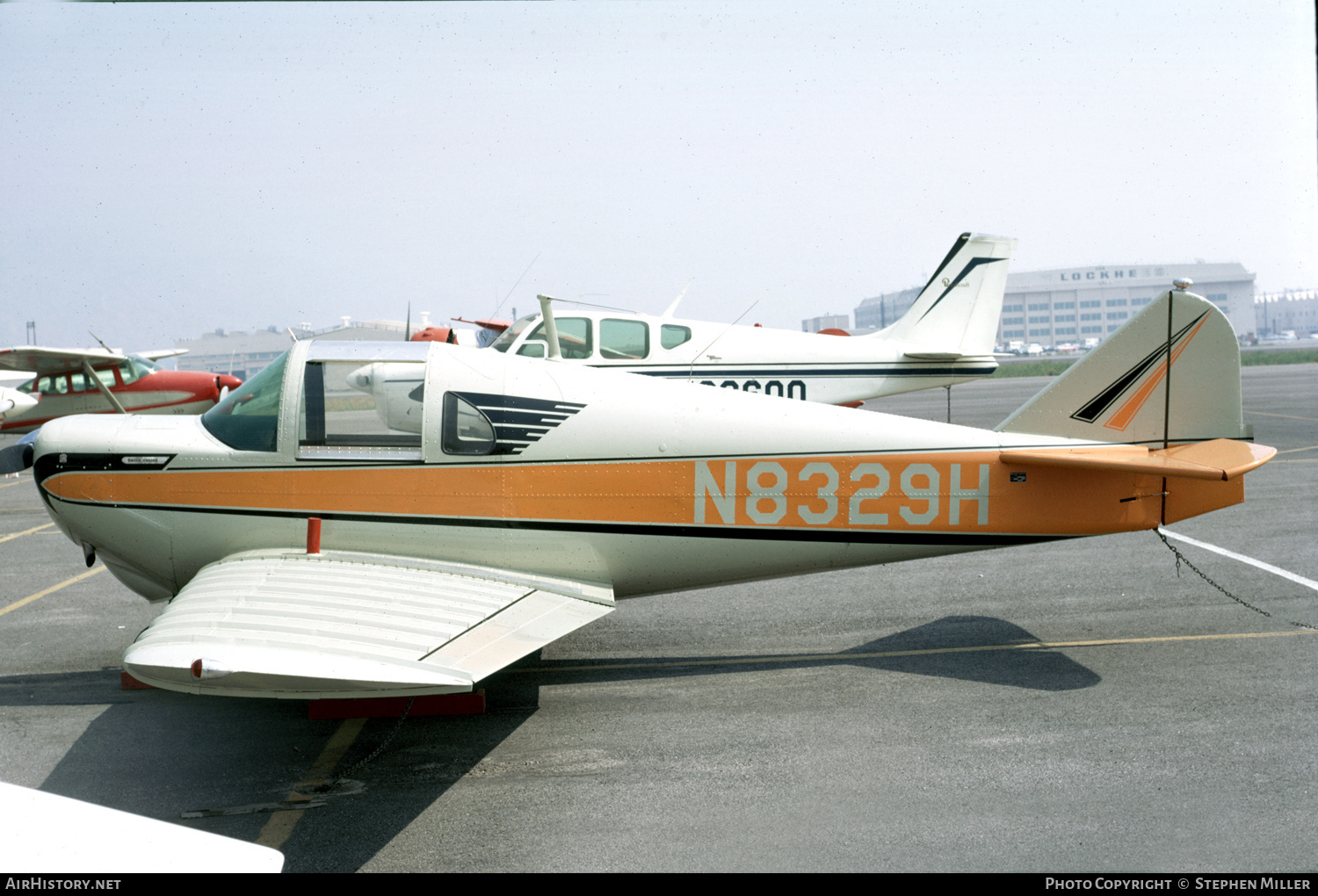

Just found your posts, not sure if anyone will even see this after 11 years, but I own an Emigh Trojan A-2 and looking for a new home for it. It hasn’t been flown since 1997. I don’t know how to attach photos here, but you can see it on google images...N8329H
