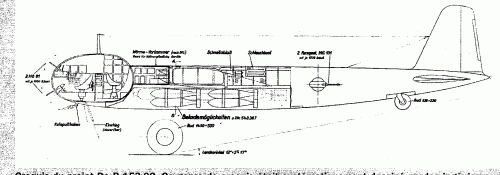

Meet the Dornier P153-02, taken from "Les Avions Dornier", by Pierre Gaillard.
Most probably from 1939, it is an impressive concept of, to my guess, a bomber meant to long atlantic action, according to the size, armament (mind the torpedo complement, I bet 2 Lt5) and especially the more uncommon "katapulthaken"(catapult hook). Was it intended to be launched by one of the Luftwaffe`s catapult ships? Recovery would be a nasty job :D !

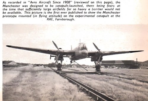

I would rather think, that it was intended for a land-based catapult system, similar the British
one, which AFAIK was tested using the Avro Manchester. The aim was, to increase the MTOW,
so landing would have been always conventional.

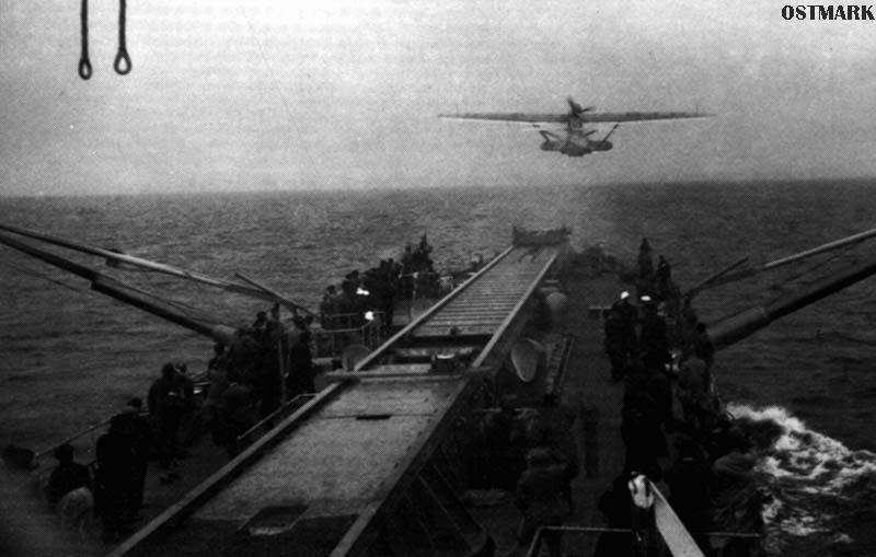

Quite possible, although additionally, it may have been also intended to be capable of operation from some of the Luftwaffe's seaplane tenders, the Ostmark for example, with recovery normally at land bases.
Ostmark Launching a seaplane [IMAGE CREDIT: Hazegray.org]​
http://www.hazegray.org/navhist/carriers/germany.htm#stin​

That would make sense, a land-based catapult like the ones developed by Ernst Heinkel. I recall seeing one photo.
Could, of course been a concept for attacking targets too far away for a conventional launch from an airfield.
But those catapult ships could have held two, at best three such aircraft on their way to the launching point.
Hardly enough for a worthwhile attack, I think. And catapult ships were in short supply !
As well as the catapult at Farnborough, there was also one built at RAF Harwell, parts of which were only finally buried a few years ago
