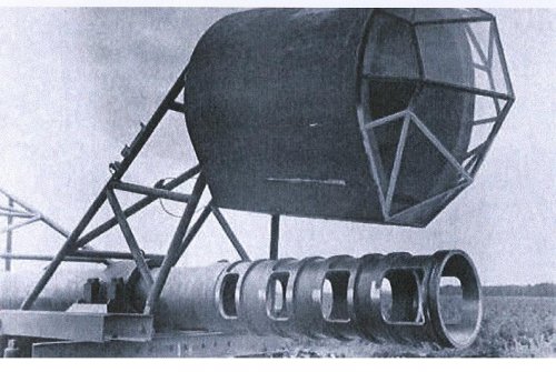

Dusenkanone Marine 44
I managed found a reference to a recoilless coastal gun:
"28.0 cm Düsenkanone Marine 44 Development started in 1943, only one prototype built."
http://forum.axishistory.com/viewtopic.php?t=124058
No photos or anything else, however...

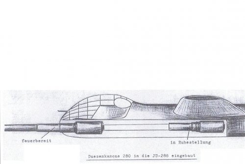

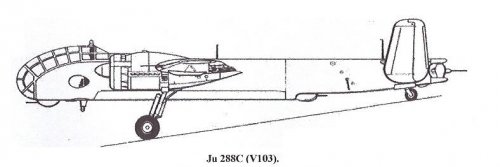

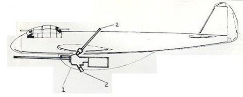

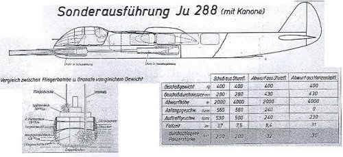

Recoilless 28 cm, sounds like something I read in Luftwaffe Secret Projects: Attack Planes... Just a sec
Here I have it:
Luftwaffe Secret Projects: Ground Attack and Special Purpose Aircraft
P262:Düsenkanone Düka 280 Bordwaffe. To be carried by the Ju 288 as a one shot weapon against heavily fortified targets, such as armored ships.
Düsenkanone
There seems to have been another Düsenkanone (jet-cannon?) of 88 variety with revolver type magazine for aircraft.

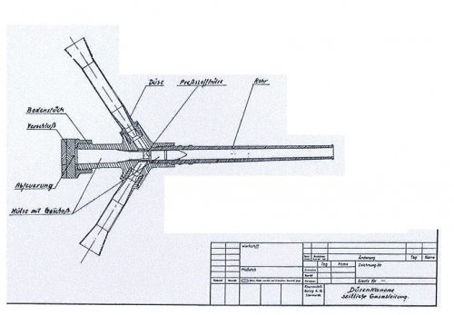

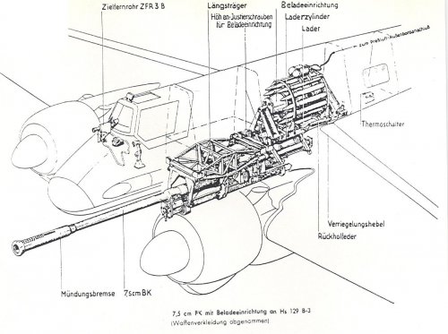

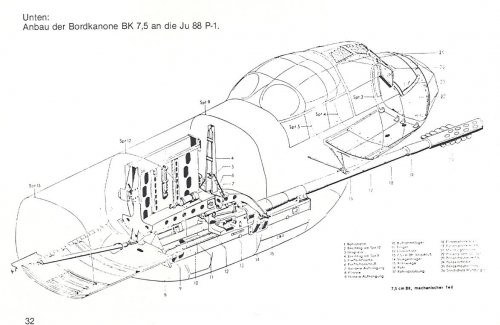

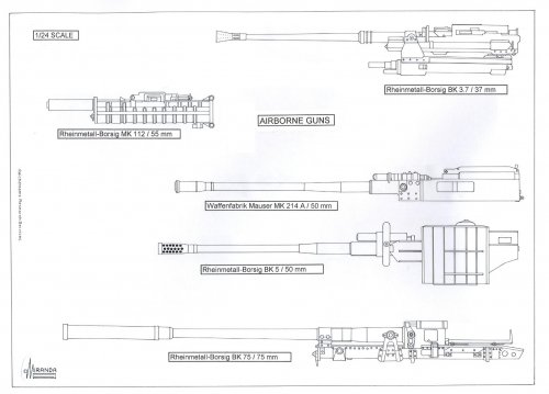

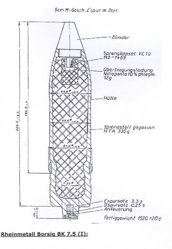

Please see attached some german heavy airguns stuff
-BK 3.7
-MK 112
-MK 214
-BK 5
-BK 75

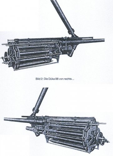

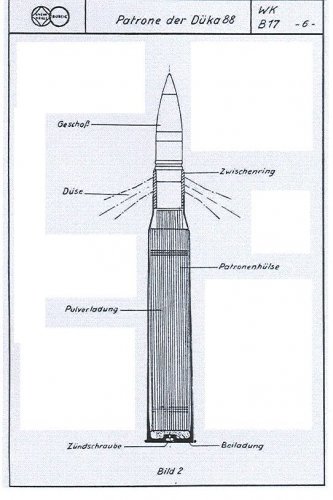

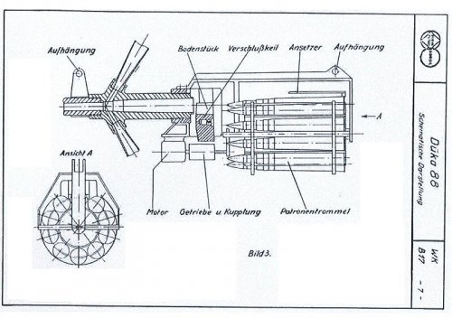

-DüKa 88
-DüKa 280

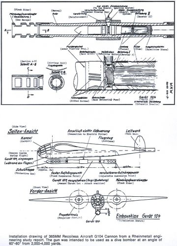

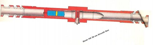

-Gerät 104
Thus most is said. It is more than probable that recoilless land designs would at least be based on the designs shown above, and in the other thread.
