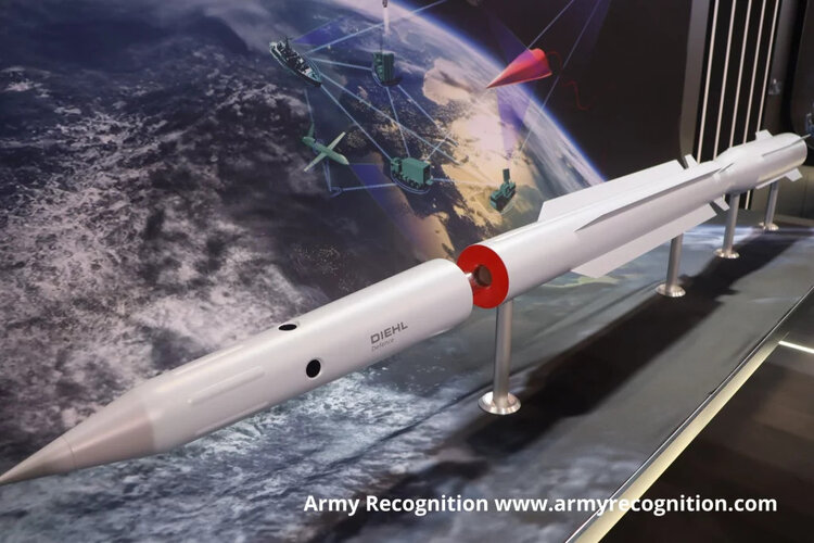

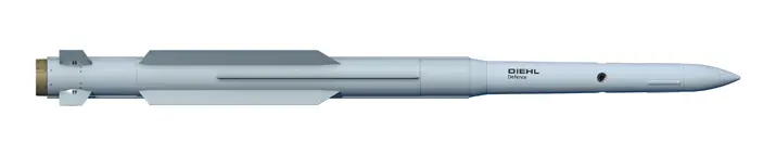

Yeah but the newer "concept" does have the booster. Maybe we even see the booster version with the ramjet motor.

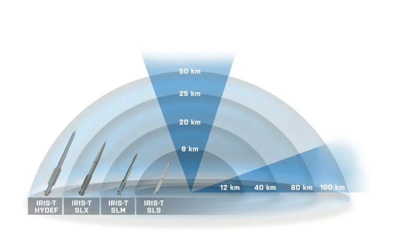

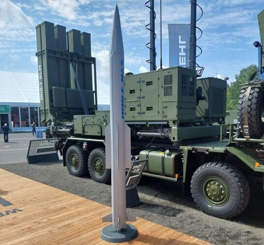

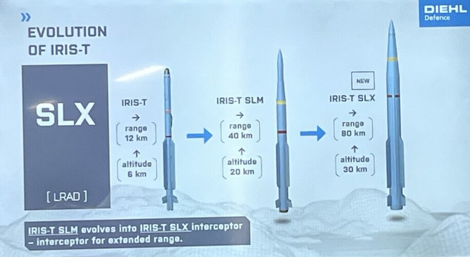

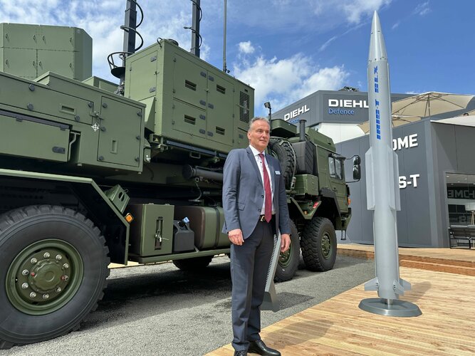

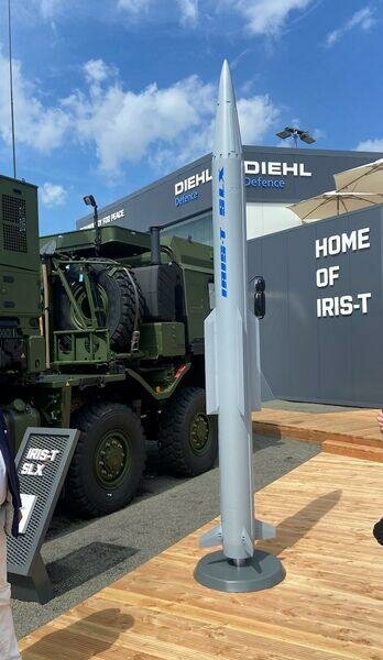

Maybe they intend applying a booster to the SLX too, because 80km does not seem like enough for glide-bombing aircraft. Any word on diameters or dimensions for SLX and HYDEF?
Can they quad-pack in a Mk41 box?
No clue / the company didn't Say anything about it as far as i know. Tought based on my guess i would say that its size is around PA-3 MSE SRM or inbetween ESSM and SM-2 but its hard to say. Can't Count the Pixels to calculate a Numbers but maybe someone other can do it here.
I would not trust this picture as a base to make some measurement.
Yeah there more off it from more angles. But including the stand its not mutch larger than the truck which is a good indicator. We know its +3m given that SLS IS already ~2.9m Long and its bigger brother SLM should be around 3-3.1m. based on that we can estimate some 3.3-3.7m or what i would say +/-0.1 around 3.5m. Close to an ESSM 1000047858.jpg
