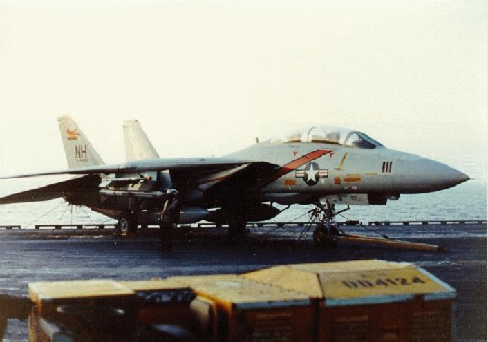

the USN didnt deploy them to the Midway class carriers which went from Phantom to Hornet and the Midways were larger than CVA-01.
The only reason the USN didn't fly Tomcats off of the Midway class was their hanger height. The Midways only had a 17.5' hangar. With such low clearance, it was impossible to perform ejection seat maintenance or landing gear drop checks on Tomcats aboard the class. With taller hangers F-14s could have been operated off the Midway class. In fact, Tomcats did fly off Coral Sea and Midway was able to launch and recover Tomcats when their own carrier was unable to accept them.
Not true. Another reason was that class would have had to had upgraded catapults and the larger jet blast deflectors (JBD) installed along with new pumps in the firemain system to handle the 2000 gpm water cooling requirement for those JBD's.
On the few occasions where an F-14 did fly off one of these ships, the area behind the catapult had to be cleared of parked aircraft and the F-14 was restricted in launch weight.

Some F-14 on Midway Class stories, with videos!

Anyway, the point being the inability of the Midways to consistently operate Tomcats has more to do with their WW2 origins than their size, and that because the Midways couldn't does not mean we can dismiss the CVA-01's ability to do so out of hand.

https://flic.kr/p/x4ajQ2 View: https://www.flickr.com/photos/davids_world_2011/20382828641
If you mean on a Det and expected to perform actual operations for any lengthy period? No, at least not without months of pre-planning and an abysmal tempo. The F-14 was a maintenance hog and CVA-01 wouldn't be able to adequately support a visiting VF, not without compromising her own air wing. Not embarking F-4Ks at all and relying on the visiting F-14s for air defence exclusively would ease this to an extent but only so far and probably wouldn't be palatable. I strongly suspect neither CVA-01 or the F-14s would perform to the satisfaction of either of their crews under such circumstances. Detachments among common types are fraught enough!
