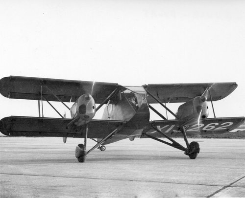

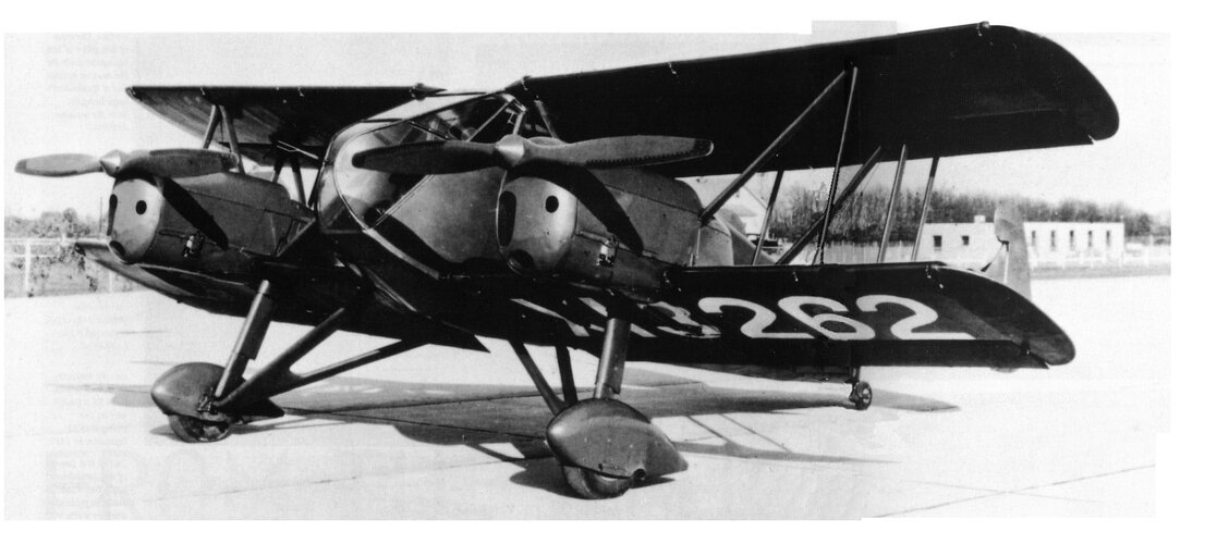

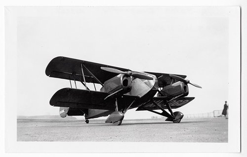

Gentlemen, in Aerofiles http://aerofiles.com/_cl.html is written that Dragonfly is two-engine aircraft and has counter-rotating props. But in both photos is seen only one engine and one usual 2-blade prop. Could you explain this disconcordance?
The Crouch-Bolas Dragonfly was a testbed-aircraft for
ultra slow flying and opererations in the STOL mode.
The plane was several times re-engined and rebuilt.
The airframe was completed in 1933 and the two oppositely rotating Dragon IV-G's
were pre-flight tested.Later Menasco B4 engines were acquired because one of the
Dragon engines broke down after 40h running.
The Dragonfly became airborne during a test in April 1934 after a roll of only 15m.
The slipstream covered almost 70% of the wing surface and the biplane configuration was chosen
with 2 engines for optimal STOL effect.
So far the abrieved text from the article mentioned.
The photo from Aerofiles is a bit misleading beaucause of the angle it was taken.
The Dragonfly had twin, wing-mounted engines (the only form it was flown in). Props were contra-rotating only in the sense that the engines were 'handed' with the propellers turning in opposite directions.
Both Aerofile photos ( http://aerofiles.com/crouchbolas.jpg and http://aerofiles.com/crouch.jpg ) show the Dragonfly in the above configuration although only the starboard or port engine/prop are visible in either image.
lark, Apophenia, thank you.
Really there are two engines! :eek:

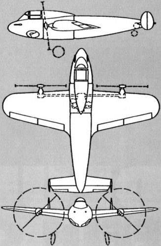

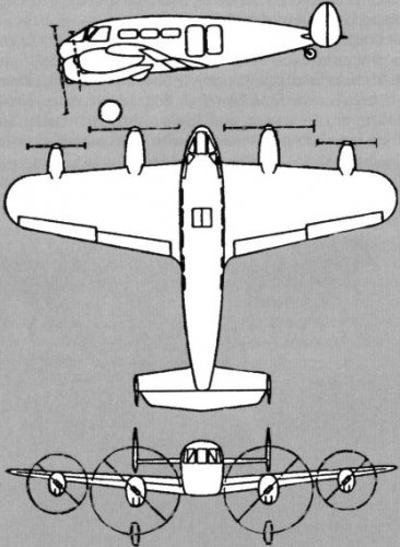

Re: Crouch-Bolas light transport projects
it was Crouch-Bolas B-40 light transport project,here is the B-37 high
speed transport monoplane project,powered by single engine driven
two propellers.
http://crimso.msk.ru/Site/Crafts/Craft21822.htm
