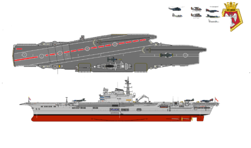

If I had a clean piece of paper the RN in 1982 would have had three improved Eagle type carriers operating F4, Buccaneer, a new AEW/COD platform (Anglo French?) Seakings while a VG strike/attacker similar to UKVG (or AFVG) would be about to enter service.
How do I get there politically?
In the aftermath of Suez where Eagle provided much airpower (with Bulwark and Albion) the RN decides to order an unarmed( no guns) version of Eagle to replace Ark, Eagle, Vic and Hermes by 1970.
