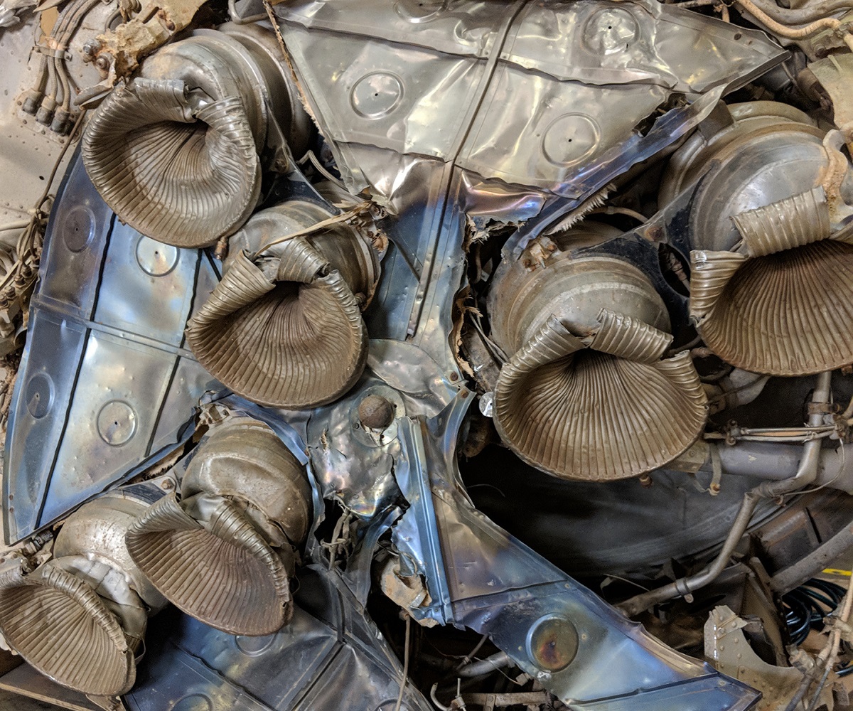

In other news:
https://www.telegraph.co.uk/science/2019/01/21/britains-satellite-launching-rocket-go-display-48-years-desert/
BBSwe0e.img
ORIGINAL CAPTION: © PA Undated Skyrora handout photo of the remains of the Black Arrow projectile, the UK's only rocket to successfully launch a satellite into orbit
https://www.msn.com/en-gb/news/uknews/britains-only-satellite-launching-rocket-to-go-on-display-after-48-years-in-the-desert (Mirror of original article with the addition of the above image.)
