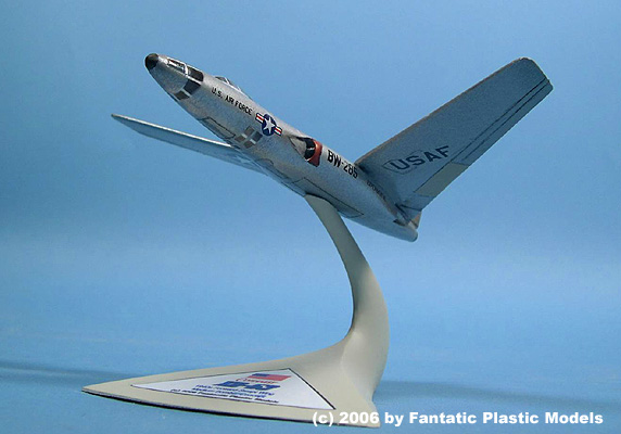

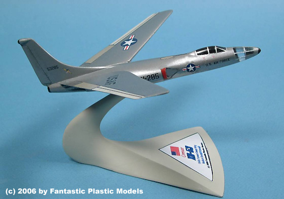

In 1/144 scale.
Available here:
http://www.fantastic-plastic.com/ConvairXB-53CataloguePage.htm

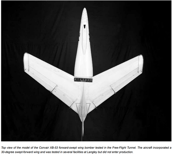

...An old NACA Langley clip of wind tunnel tests of this design:
http://www.youtube.com/watch?v=ZCPI45YNM0E
Very interesting.

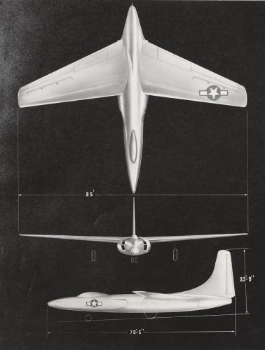

I was asking for a 3d view for this plane, but I found this thread:
http://www.secretprojects.co.uk/forum/index.php/topic,5164.msg102150/highlight,xb-53.html#msg102150
I understand now the A-44 is the same plane than XB-53. Is this correct ?
Yes, correct. The USAF no longer desired an "A for attack" class of aircraft and reallocated A-42 as B-42, A-43 as F-87, A-44 as B-53 and A-45 as B-51.
Of course, being redesignated as a fighter, the A-43 project became a slighty different bird, and the same goes for the B-51 bomber.

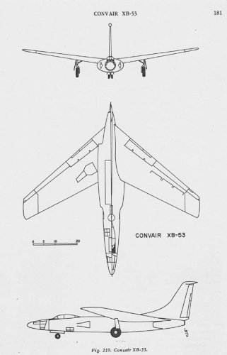

Here's another GA drawing of the XB-53
(from Lloyd S. Jones "U.S. Bombers B1 - B70", Aero Publishers Inc., 1962)

All these decades I've been reading about and watching videos of aircraft and I don't recall realizing that some wind tunnel tests have been done tethered instead of mounted on a post or lever arm.
