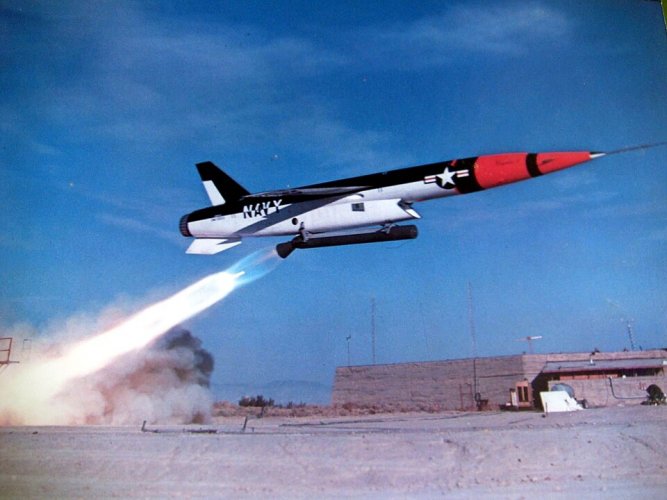

Had an idea pop up in the "Designing a new Interceptor" thread: what happens when your long-range manned interceptors are shot down or otherwise not available, and the cruise missiles keep coming?
And I came up with an absolutely ridiculous "kamikaze CCA" that was really more of a beast of a SAM. 21" diameter like the SM6blk1b, but a solid-fuel ramjet like Meteor with 4 intakes. Enormous booster to cover the first 10,000ft in elevation and Mach 1 speed. Meteor has a booster to get it up to ramjet start speed inside the length of the regular missile, so this would as well. And now you have a 21" GaN AESA radar at ~100,000ft or so and M5ish searching for the incoming cruise missiles. Being able to recover the thing is entirely optional. Likely cost is going to be about the same as the SM6blk1b as well for the airframe, plus development of the search and attack autonomy.
For the USN CCAs.
