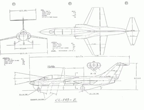

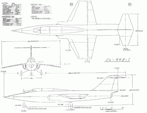

From early 1957 are the next two designs. CL-342 was a miimum supersonic trainer with a Mach 1.5 maximum speed, powered by two J-85s. The contemporray CL-343 had a speed reduced to Mach 1.0 due the lone Westinghouse J-54 powering it.The fuselage of the F-104 was more deeply modified. There were two iterations of this design, but the two differed in minor details.

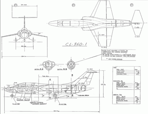

From mid-1957 is finally the CL-360, defined an "optimum two-place supersonic trainer". The engine is unspecified but described as having the power of two J-85s.

Hi Skybolt!
Thank you very much. Very good, but I am talking about the competition SS-420L/TZ/Northrop T-38.These projects (CL-342,-343,-360) were created later SS-420L. I think of these projects, only the CL-314, was involved in this competition.
mmm, maybe yes, maybe no. The TDNs were assigned to studies under contract from USAF. Maybe they weren't all that sure of their choice.
