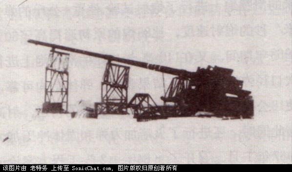

This series of artillery is a product of China's anti-ballistic missile system in the 1960s and does not take ground attack into account
“21 m long”,“ 85 mm shells ”,"Payload: 40 kg"It's not the same gun
