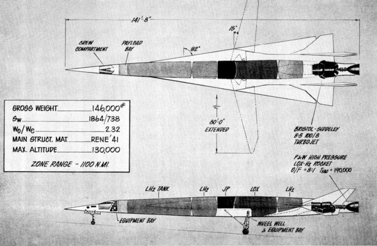

Think it was one of Convair ISINGLASS concepts.
Sounds right...
Ah, here it is! https://www.secretprojects.co.uk/threads/project-isinglass-project-rheinberry.382/post-474758
Convair early availability design R-3. Rocket powered to Mach 9 and 130kft via a 190klb thrust rocket. Subsonic propulsion prior to rocket ignition by a BS.100/8 for travel to rocket ignition spot and after the zoom pass to landing point. No landing a huge glider with an enormous sink rate!
Image from https://www.secretprojects.co.uk/threads/project-isinglass-project-rheinberry.382/post-489595
