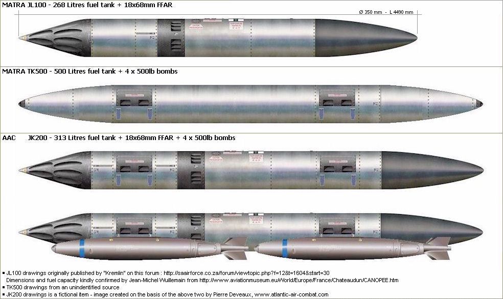

-moar rockets carried in Matra JL-100 hybrid fuel tanks, underwing (2 or 4 of them)
- https://heller-forever.forumactif.c...ettes-et-reservoir-supplementaire-matra-jl100

- 18 FFAR per JL-100, that's 36 more rockets on top of 126, total 162 FFARs...
And thus, all things done... with 162 rockets per interceptor, only 5 of them can decimate an entire night worth of russian Shahed waves... 810 drones.

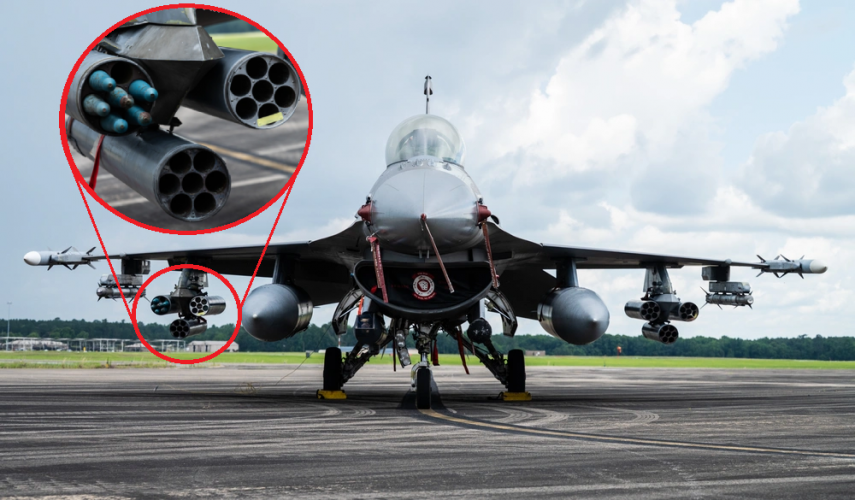

Why bother? A typical F-16 could carry up to three 7-tube rocket pods for 70-mm Hydra's under each of his four main pylons:
It's 21 rockets per pylon - up to 84 rockets per plane, if all four main pylons are used. With added guidance modules on rockets and laser targeting pod under belly, it would work as good as old F-89D.

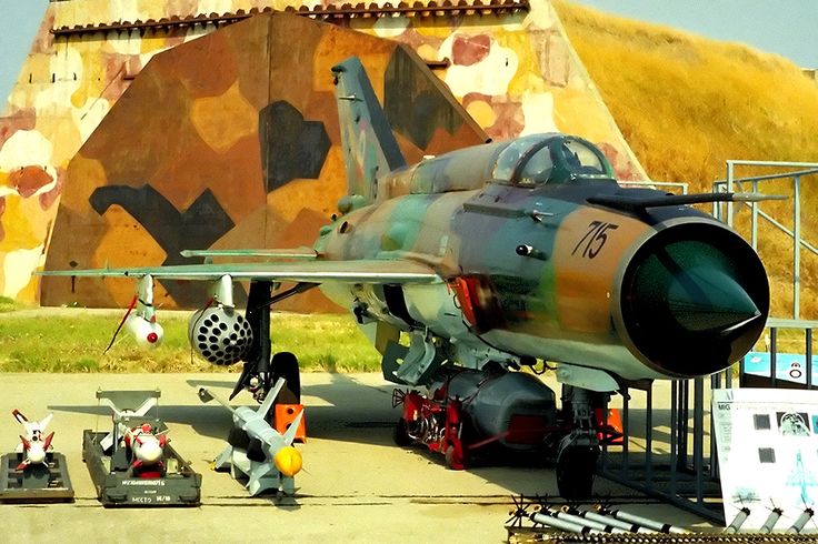

A Mig-21 Lancer equiped with 2x32 rockets pods (total 64 rockets), 2 IR AA missiles (if you find Something more juicy like a cruise missile) and a recce pod, good for finding targets with low radar signature..
The F-89 and F-94 are since long time retired, but you can still find perfectly functional Mig-21s at bargain prices.
