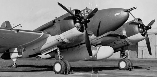

Australian CAC CA-4 and CAC CA-11 Woomera bomber prototypes 2 x 250 lb bombs in each nacelle bay.
In the attached image, bomb doors can be seen on either side of the undercarriage legs.
