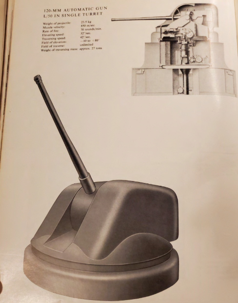

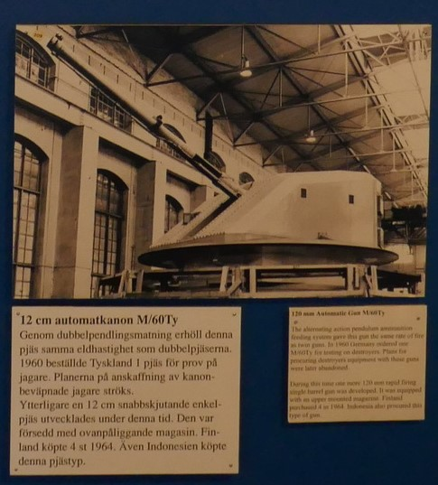

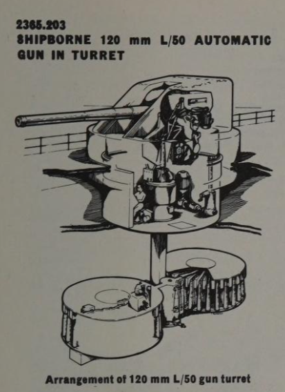

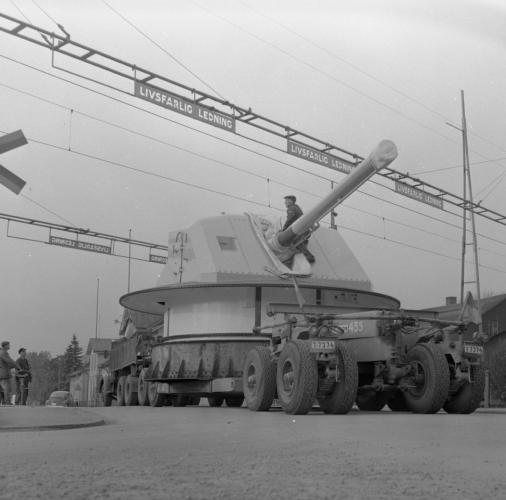

Variously called, the Bofors 120/50 M/60Ty (Tyskland = Germany) was a Bofors late 1950's project for a new generation 120 mm ship mounted autocannon, replacing their twin barrel system from 1950, instead opting for a single barrel system with double the rate of fire. The German Navy showed interest and ordered a prototype for a destroyer but that's about it. Anyone have any more info?
