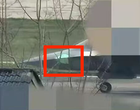

Just correcting some mis-infos
The fact that the canards and main wings aren’t parallel, doesn’t prove that it’s dihedral.
Even if two lines are in the same plane, if they aren’t parallel, from any viewpoint it will still be remained unparallel

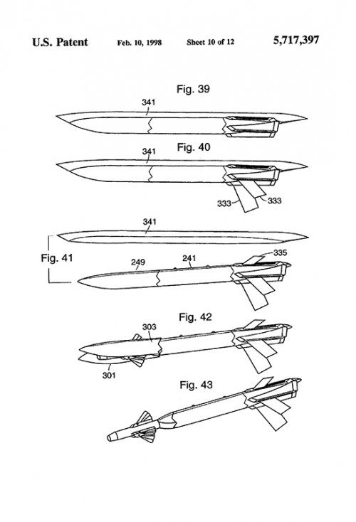

It's not as ideal as internal carriage, but from a drag and signatures perspective, it's typically better than the alternative of pylon and adapter.
From a signatures perspective, not really. Conformal carriage was seen as a possible solution back in the 1980s but didn't pan out very well for many reasons, including signature. The external weapons still have to work with the geometry of the parent aircraft, which is actually somewhat harder with conformal vs. a pylon. A pylon with a "stealth pod" like what was proposed for the F-18E is generally superior to conformal carriage for a number of reasons including signature. There were also solutions that involved putting low observable "facades" on the weapons that would be mounted to pylons, I believe there was a patent on that (Northrop?).

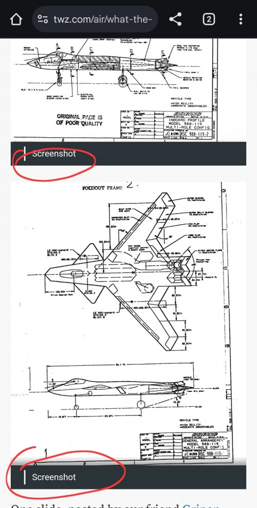

This looks like it has some substantial interior volume. I expect the design's moved on a lot since this was published, but still...

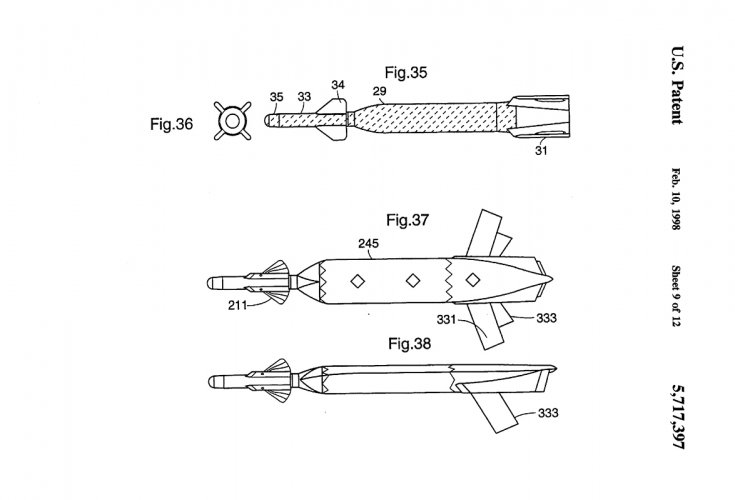

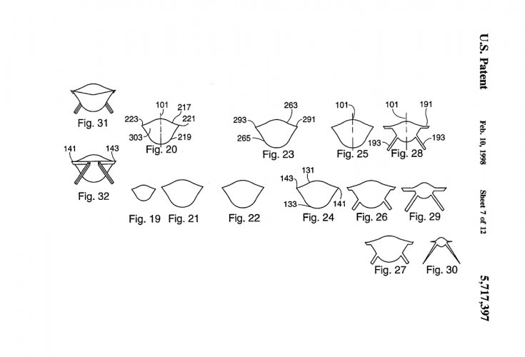

There were also s that involved putting low observable "facades" on the weapons that would be mounted to pylons, I believe there was a patent on that (Northrop?).

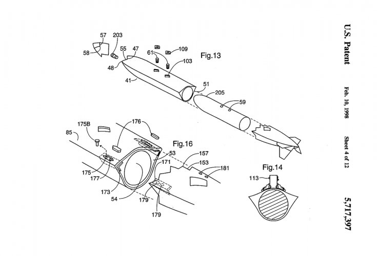

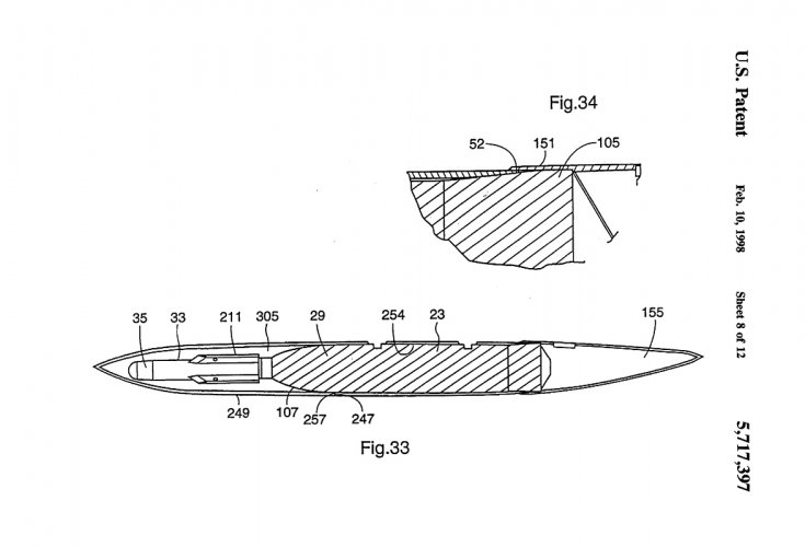

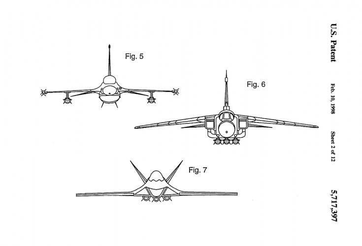

IIRC Lockheed had some patents like these:
US5717397_03.jpg US5717397_04.jpg US5717397_05.jpg US5717397_08.jpg US5717397_09.jpg US5717397_10.jpg US5717397_11.jpg

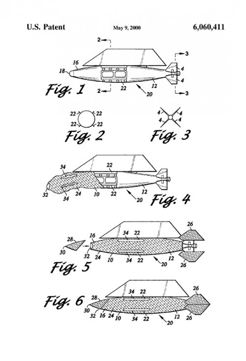

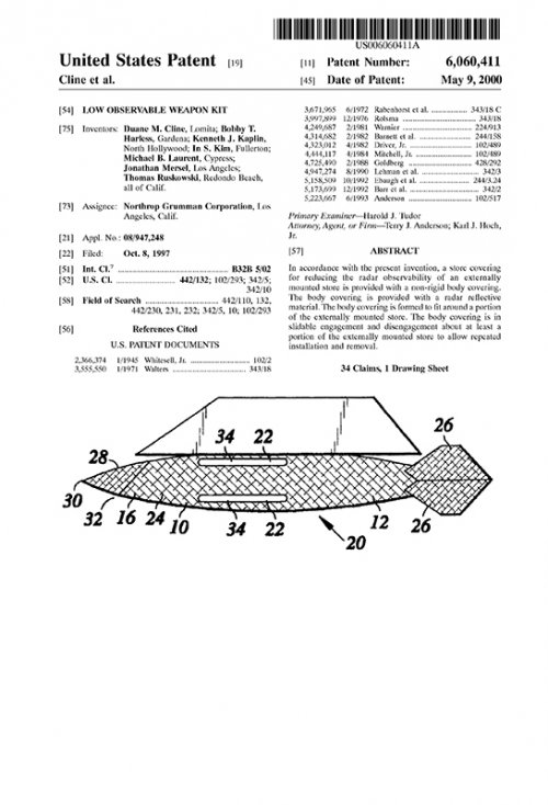

Northrop's solution is.....eh...weird......

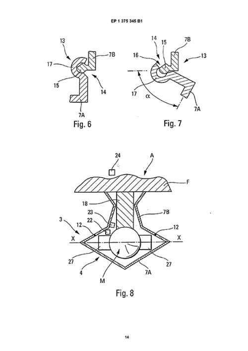

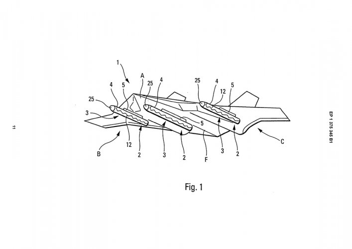

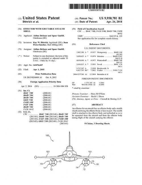

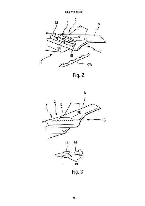

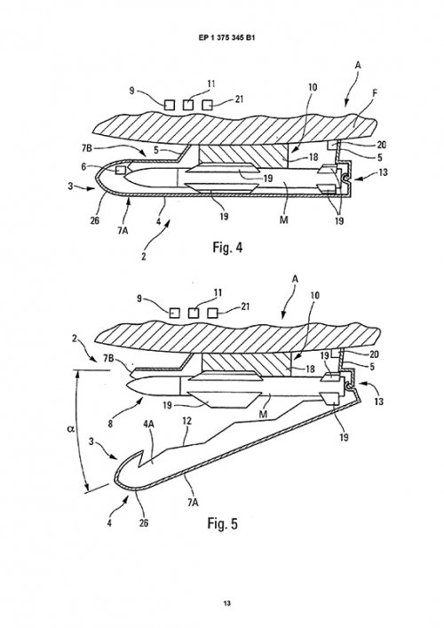

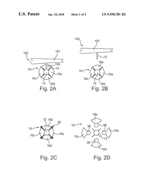

Airbus and BAE also had some similar designs:
True, except that, assuming parallel lines, the further the line, the closer to horizontal it should look.
On the B-21 picture, the blue trailing edge is "flatter" than the red leading edge, their vanishing point being somewhere on the left of the image.
As for the F-47, the blue line is "steeper", and their vanishing point (not sure if it's the right technical word, as as in "point de fuite" en français) is in the opposite direction.
So either thet are not parallel (unlikely but possible), or there is indeed a dihedral.
If we remove the shadows that inherently create the segmentation that we understand is a canard, wouldn't someone end-up with a CRANE type of wing?
IMO we can make a distinction b/w a void in black and, on the right of it, a surrimposed line that cuts the continuity b/w what we identify as a canard and the wing behind. Remove that and you have a tandem wing as illustrated above.
That would explain the aggravated camber of the said so canard that matches that of the section of the wing seen behind.

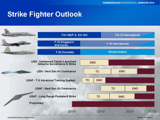

Thought it might be time to check the scorecard.
Here's a (shocking) slide from the briefing at Farnborough in July 2010 by a former Sr VP at Boeing Defense, named Shelley Lavender. The "Proprietary" bar is Boeing-speak for a black program ... Can't believe the AF approved this for public release. I've never come across anything nearly as inappropriate from LM or NG. I do know for a fact that Boeing has routinely referred to at least one other unacknowledged DoD program as Proprietary in a unclassified setting.
Be that as it may, Boeing Defense has been incredibly successful at capturing new business in accordance with their coherent roadmap.
  • UCLASS > CBARS > MQ-25....check
  • USN NGAD > F/A-XX > ?........ tbd
  • T-X > T-7........................................check
  • NGAD PCA > F-47......................check
  • LRS-B > B-21 ................................nope
  • "Proprietary" ................................check
The black program, aka Proprietary, appears to have entered LRIP about the time this slide was presented. I have a thought as to what that aircraft is, but my mother taught me that two wrongs don't make a right. Regardless, St Louis has quietly gotten very busy even before the F-47 award. And this week we are likely hear that they won F/A-XX too. Who would have guessed such a turnaround? Mr. Mac is probably hootin' and hollerin' from his grave.
