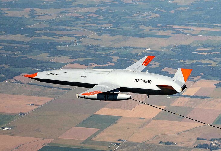

Boeing UCLASS demonstrator that became MQ-25
https://www.secretprojects.co.uk/th...rs-mq-xx-mq-25-stingray-program.16346/page-19

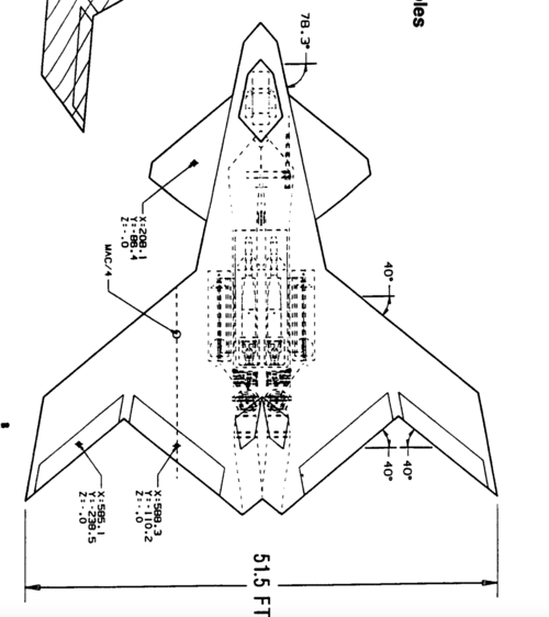

review_a-jpg.763930

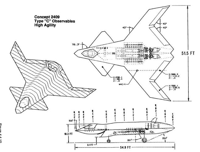

You can see here that the "high stealth, high agility" design adds canards to essentially a four-lobe B-2 derivative planform.
dbc-stealth-interceptor-1983sm-png.180819
The Northrop "Xmas Tree" high stealth ATF has essentially a similar design. Not the control surfaces on the rear of a fixed canard - this is one way to build a stealthy canard (front part is fixed, deep RAS structure, doesn't move - rear moves, sealed with with flexible skin on potentially locks in place for high stealth scenarios but unlocks when needed for agility).

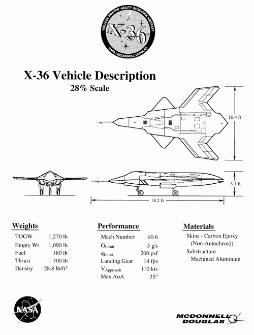

some 2409 / X-36 planform heritage vibes?
This is the closest I can place the second rendering to though there's so little released that it is difficult to make out what's real vs what's more of a placeholder. If true though this will be a very distinct looking aircraft. Certainly far away from an 'evolutionary' advancement over F-22/F-35 designs

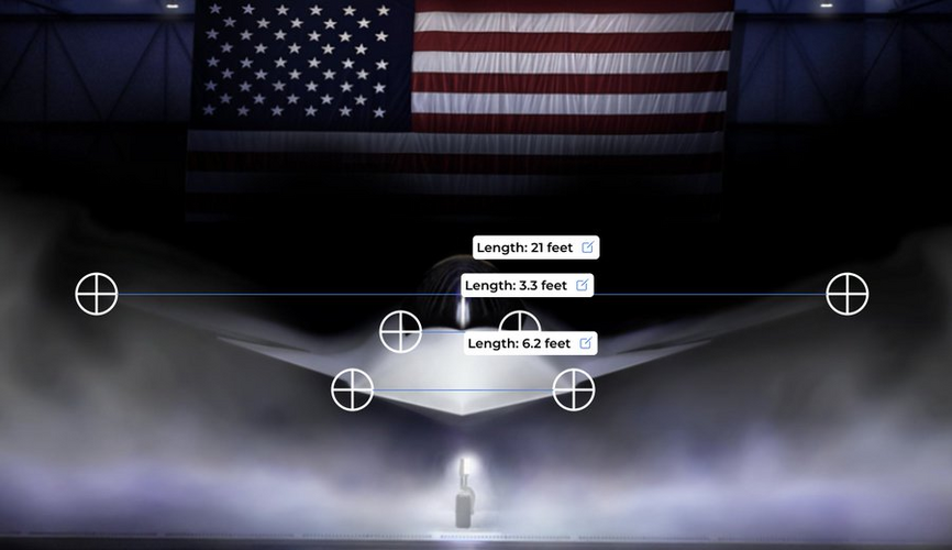

So people here have noticed that the F-47 nose landing gear only has one tire, which hints that the MTOW is likely not that high, and indicates that the aircraft isn't as huge as some had thought. In fact, if F-47 really is about the size of an F-22 as some said, but with much lighter structural weight for more fuel fraction, based on that information I'm making my rough estimate on F-47.
Empty weight: 39,000 lbs (over 4,000 lbs lighter than F-22)
Fuel: 25,000 lbs, 0.64 empty fuel fraction,
Weapons: 6x AIM-260 JATM, assuming 350 lbs per missile, and 2x AIM-9X, 2,476 lbs
Takeoff weight: ~66,700 lbs (assuming 200 lb pilot)
Thrust: 2x XA102/XA103 each producing 35,000lbf thrust
T/W ratio: 1.05 at takeoff weight
g-limit: +7.33 (even most maneuverable fighter only sustain 9g under 10,000ft anyways)
This gives a loaded fuel fraction of 0.375, and using the Breguet range equation as a surrogate for combat radius, this means that just by fuel fraction alone, range has increased by 43.6% from the F-22's combat radius numbers of 595nmi subsonic and 460nmi with 100nmi supercruise. Combine that with the NGAP goal of increase mixed supersonic/subsonic combat radius by 38%, and assuming that the NGAD/PCA has 30% better L/D due to more advanced aerodynamics over the past 30 years, you get about 1,200nmi combat radius with 260nmi in supercruise.
For the F-47 to be about the same size as an F-22, that's extremely impressive, but it goes to show what 30 years of advancement in aerodynamics and propulsion can achieve.
But the fact that the F-47 is not a very large aircraft, at least not much different from legacy fighters, has interesting implications in terms of operational usage. That could mean it can operate from shorter and more austere runways compared to a large aircraft, which may be critical for INDOPACOM, being able to use smaller Second Island Chain bases. And also use existing shelters and infrastructure. So that means, it can operate from the same kind of shorter, austere bases that the F-22 has recently been deploying out of in their ACE testing.

Could the dihedral effect on the images be exaggerated by a short nose gear leg?

Boeing UCLASS -- the link's info is a bit sketchy, not sure what to make of it. I know Boeing was disappointed with their loss of the N-UCAV demonstrator to Northrop (X-45N vs X-47B). It's certainly possible that Boeing went ahead with a self-funded (fully or partially) classified UCLASS demonstrator (of carrier-suitability and shipboard C3) after Naval UCAV went away, but again I'm having trouble with this idea from a money perspective (not a compelling business case for Boeing; too much intra-Navy competition for limited technology R&D dollars). A related sidenote: the CBARS program, which led to the MQ-25, never had a Navy operational or engineering requirement for low RCS or IR signature. Any planform shaping or inlet/nozzle design features were incorporated by way of Boeing's own initiative, probably from their internal work and vision of future UCLASS-like missions derivatives and/or more survivable tanking aircraft.

The Navy, at the time, certainly knew that they wanted an aircraft capable of operating from a carrier and all the requirements that came with with. They also knew that they were seeking an air to ground aircraft (with a certain payload mass and volume). And they knew that they did not require the next-generation engines and some of the other Air Force needs. These were all requirements for the demonstrator, not an operational aircraft.
The UCLASS/CBARS/etc. dynasty of programs changed the requirements for the Navy UAV/UCAV several times. It was an ISR and strike aircraft, then it was a tanker. In 2017 Boeing unveiled the classified demonstrator it had built, almost complete, for the earlier requirements. At the time their competitors had only artist's conceptions of their designs. The Boeing demonstrator became their tanker and won the contract.
