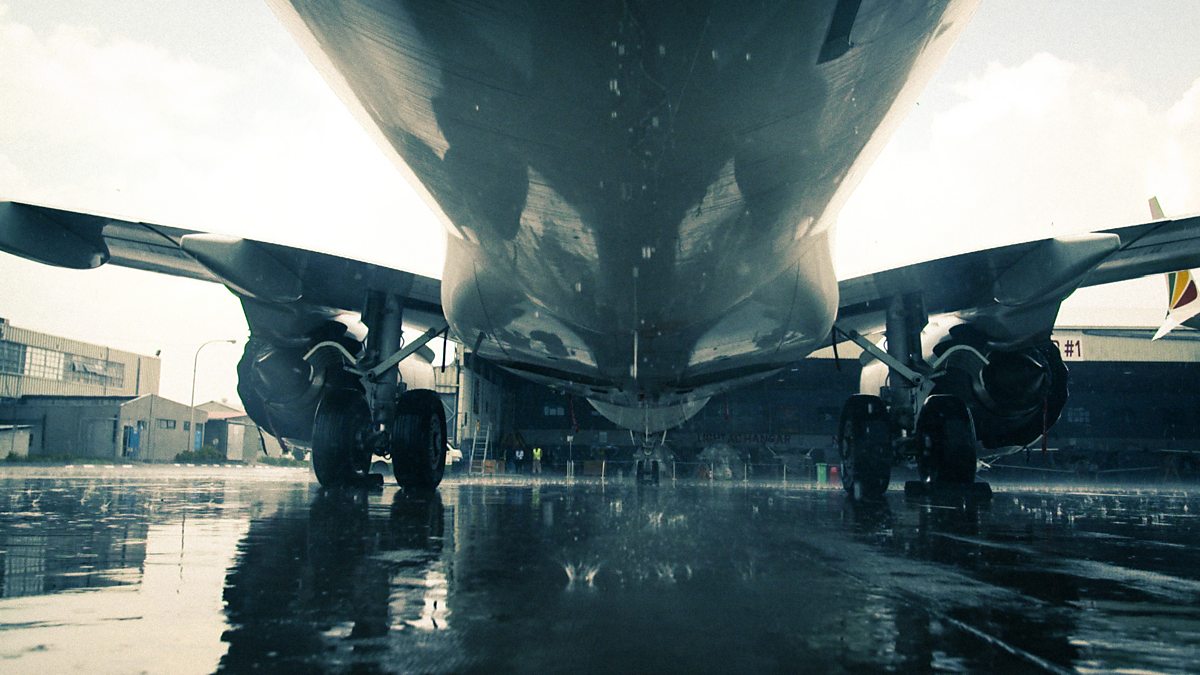

I finally found time to sit down and watch BBC Panorama's "Boeing's Killer Planes". In spite of the title it's a fairly measured assessment.
(NB, BBC iplayer's normally not available outside of the UK)
