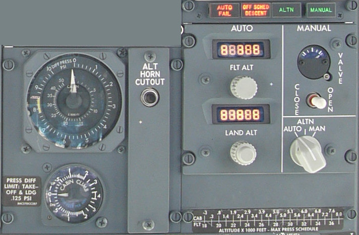

That pressurization alarm has more than 5 different triggers.
Again, from the QRH posted on scribd, but differently presented:
"This indicates that the primary automatic cabin pressurization controller was disabled by a fault condition, which can be caused by
  1. a problem with the controller itself,
  2. one of the valves it controls,
  3. an excessive pressure differential,
  4. an excessive rate of cabin pressure change, or
  5. a high cabin altitude."
Emphasis mine.
So when troubleshooting, you have multiple things to test. On the ground and in the air for each one.
Furthermore, the system does not say which of those 5+ possibilities caused the alarm. So you have to test all of them. Only one of the alarm triggers points towards the fuselage having a leak in it.
