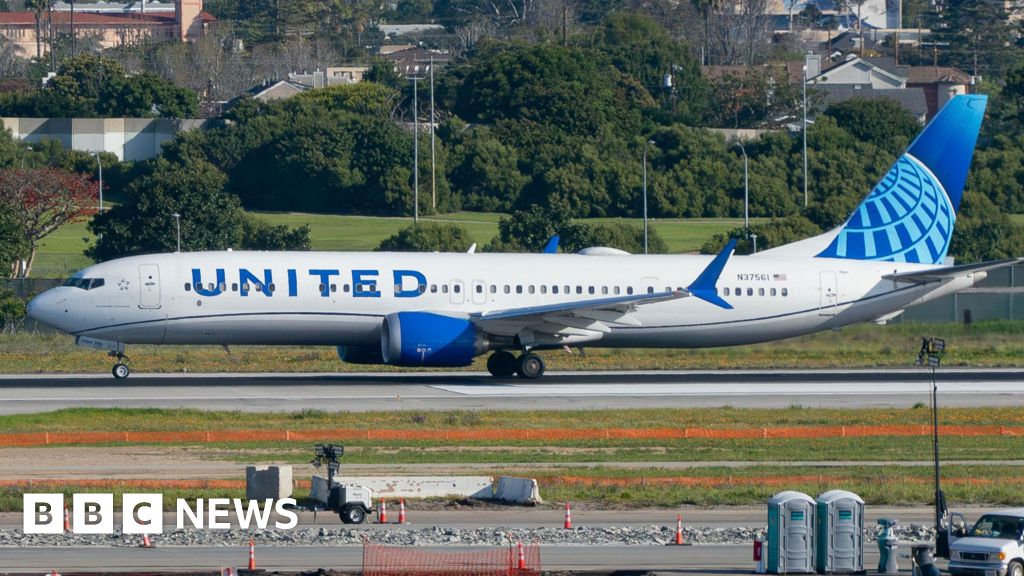

Oh, crap. "And another one bit the dust..." To be honest, it is difficult to distinguish between a) airline servicing failures and b) Boeing manufacturing failures. Of course the media has no clue and happily mix both.
Do you think that failure could be an airline mechanics mistake, and thus Boeing has nothing to do with it ?
So another Boeing 737 Max issue this time an engine Couling detaches during flight, I do wonder why the 737 Max is having all these problems. I would not like to travel on a Boeing passenger airliner right now especially the 737 Max.
It's an -800 not a Max8.
Thanks TomS, with all the issues at Boeing curently it is easy to get the airliners mixed up. Though I wonder what happened to the Couling to become detached the way that it did during flight? Is it a Boeing problem or the engine manufactures this time round?
This is not the first time this has happened to an airliner and it has happened on other manufacturers aircraft as well. This from back in 2013 re an Airbus 319.
In that case the investigation revealed the following contributory factor
"The design of the fan cowl door latching system, in which the latches are positioned at the bottom of the engine nacelle in close proximity to the ground, increased the probability that unfastened latches would not be seen during the pre‑departure inspections. The lack of the majority of the high-visibility paint finish on the latch handles reduced the conspicuity of the unfastened latches. The decision by the technicians to engage the latch handle hooks prevented the latch handles from hanging down beneath the fan cowl doors as intended, further reducing the conspicuity of the unfastened latches."
That was not the first time that had happened. There had been a similar incident at New York in 2008 on the same type..
Also ATR at Mumbai in Feb 2022.
Alaska Airlines Boeing 737-900ER in Aug 2022
