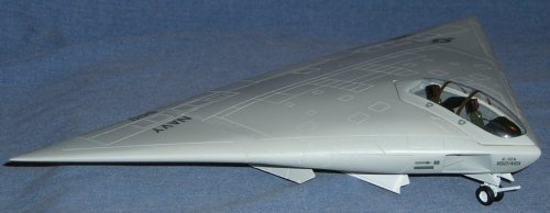

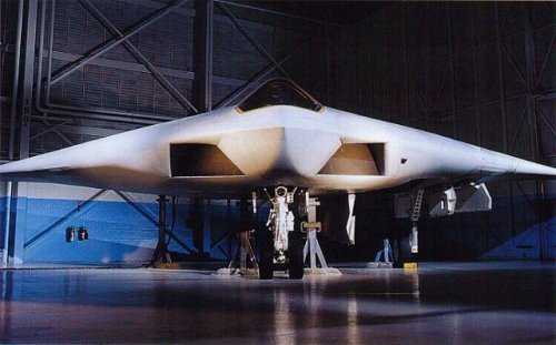

I would say the biggest mistake was the cancellation of the U.S. Navy's A-12 attack bomber because of its long-range, all-weather, stealth capabilities which our carriers haven't had since the retirement of the A-6 Intruder. The F/A-18F Super Hornet is good, but it is inferior to the A-12. The F-35 had stealth, but it lack the range of the A-12 and not optimized as a bombing platform.

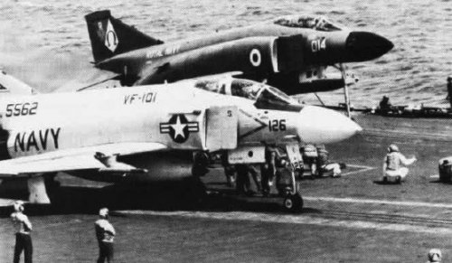

Tailspin Turtle
Dec 6, 2007
701
131
www.tommythomason.com
Abraham Gubler said:
In ideal conditions the most HMS Ark Royal in her Phantom commission could make with catapults in operations was 29 knots for only 15 minutes. CVA-01 was designed for 25 knots with catapults charged. There was a reason the RN was looking for aircraft in the 1960s with far lower minimum launch speeds than the USN.
Hence the greater F-4K nose gear extension for launch...

It is certainly true that USN catapults were more powerful than their UK equivalents, largely by virtue of operating under higher pressure steam conditions, and this clearly caused much of the RN's difficulty. However, speed drain is a problem caused by any catapult that draws its steam from the ships boilers, unless the Essex class had an additional steam plant dedicated to producing steam for the catapults (which to my knowledge they did not?) they would have had the same problem, what was their sustained speed when operating two catapults simultaneously, especially deep and dirty in the tropics which appears to be your reference for 25knots for the RN carriers? 29 knots for 15 minutes for Ark Royal seems fairly reasonable and I do not see why the Essex class (with comparable top speeds as already stated) would have managed any better unless there is a source that states that they did?
I don't think there is any confusion, the USN appears to have decided that whilst it was technically feasible (with some fudging) to operate Phantoms from the Essex class it was not wholly viable (for a whole range of reasons) and that is why it was not done. Multiple authors (including Friedman- 'Carrier Air Power' 1981) have stated that the Phantom could not be operated from the Essex class and submissions to Congressional hearings in late 60s and early 70s stated the same thing. Indeed I understand that McNamara actually told the House Armed Services Committee in 1964 that the F8 would be retained for the Essex class as that group of ships had only a marginal capability for the safe operation of the F4. Of course the RN pursued the solution of modifying the aircraft, the double extending nose-gear shown in Tailspin Turtles excellent picture, the exhaust pipes on the Speys were angled downwards and Spey itself offered more take-off power.
zen
Jul 15, 2007
2,373
1,091
I think sealordlawrence is right here on the matter of the Essex class and would add to my knowledge CVA-01 and the previous 1952 efforts were aiming at continuous speeds while'st launching. So 25kts for CVA-01 not just when charged, but while'st recharging is what I understand from my readings.
The 1952 effort aims for 30kts deep and dirty and this apparently equates with roughly 32kts deep and clean at 53,000tons.
To get the F4 operating safely from a modernised Essex would require quite a few changes to the flightdeck and I still have unanswered questions about the modernised layout as it was. Those wires look too far aft. She needs longer catapults for standard F4s and that implies more steam and thus less for propulsion.
Now 29kts for 15 minutes is an interesting figure, but it needs more than just that to actually make sense. We need how long she's been out of dock, where she is operating (temperature and humidity conditions) and we need how deeply loaded she was at the time. Indeed we also need to know the condition of her plants at the time as well.
After all we know Eagle did 30.53kts at 44,250tons displacement in temperate conditions. Considered equal to 29.6kts deep and clean (49,950tons) and corresponding to 24kts at 48,700tons six months out, though I haven't the information on whether thats predicted for the tropics or the temperate zone.
And this still leaves us Victorious.
Hermes was projected to make 25kts deep and dirty, but operation of the catapult reduced this by another 1.5kts to 23.5kts. However she had only half the installed plant of Eagle.
