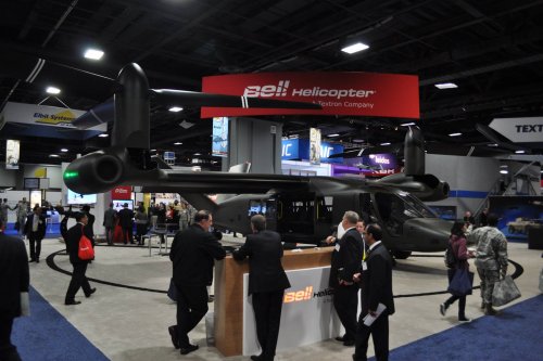

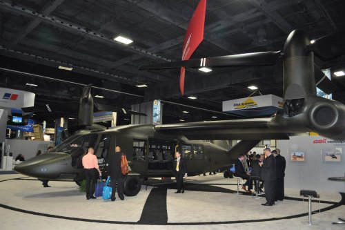

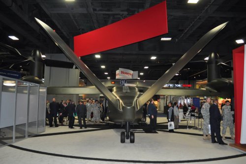

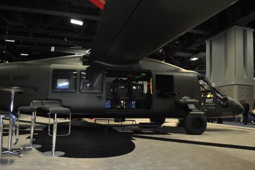

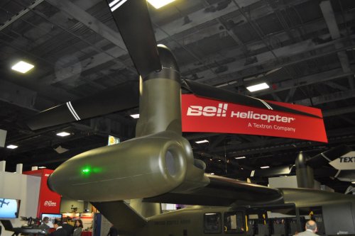

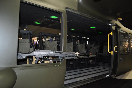

Mock-up of Bell V-280 Valor on display at AUSA 2013.

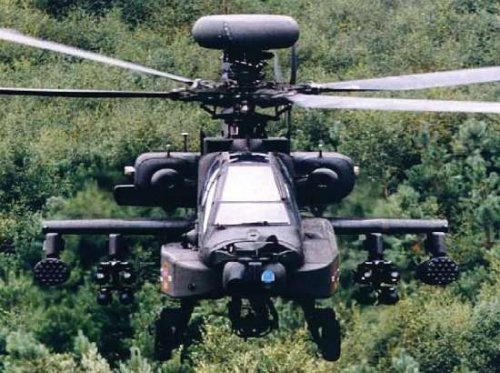

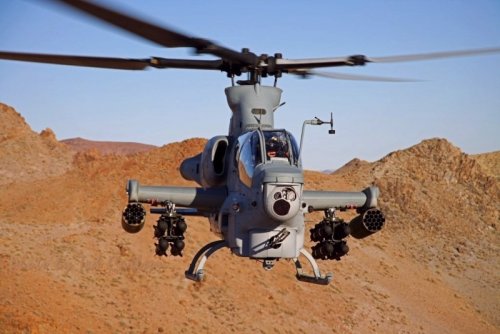

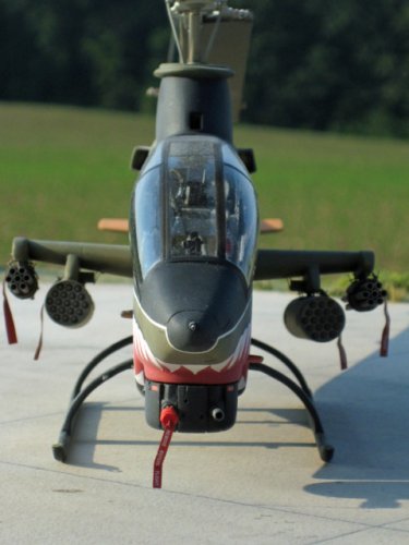

Is it possible that the Bell V-280 attack configuration is a possible replacement for the OH-58D Kiowa Warrior?
F-14D
I really did change my personal text
Oct 4, 2007
1,772
106
No, all the JMR contenders are too big and powerful. This is the size that will replace the AH-64.
Jemiba
CLEARANCE: Above Top Secret
Mar 11, 2006
8,158
760
Would mean abandoning tandem seating for attack rotor craft by the US, too, as with the Kamov Ka-52.
Of course, a tilt rotor probably has a much bigger frontal profile either. Maybe the distances to engage a
target have increased generall, so that the danger of being hit by gunfire has lessened.

I think the decision on tandem versus side-by-side is not finished. The reason you see it right now is that they are keying on the question of how much commonality can you have in the aircraft. I would not be surprised if Bell does not have a tandem fuselage design ready to hang under the wing if the decison is made to go that route.
F-14D
Oct 4, 2007
1,772
106
Only Bell and AVX have shown their attack models, and like you said they both show side-by-side. Certainly, commonality is a factor, but I wonder if they're also thinking that the way attack helos have evolved, the value of tandem seating may no longer be worth the extra cost, if it's a variant of a utility version. In the three photos I've attached, the first is of the original AH-1G. It's a model, but it clearly illustrates how thin the profile was from the front, barely wider than the crewmembers, theoretically making it a harder target to whoever's shooting back. The second is of the Zulu Cobra, and with all the new equipment you can see how much wider the frontal aspect has become. Finally, with the pic of the Apache it's obvious that considerations of a slim profile are long gone.
Now if they were startting from scratch to build a straight-up attack bird they'd almost certainly do a tandem fuselage. Sikorsky has given us plenty of artists' concepts of exatly that. But in this case it appears Army is looking for commonality and cots savings where they can get it. Given that, and the fact that the attack verions of these vehicles won't be any faster than the utility versions, maybe they're all thinking that the cost of a separate fuselage just isn't worth it. Then again, I could be all wet (again).

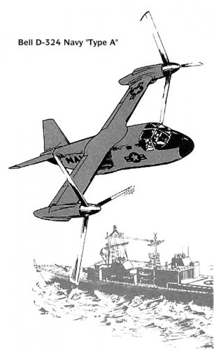

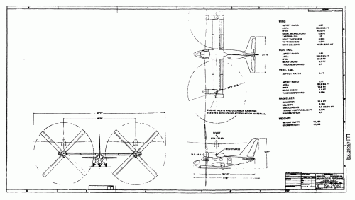

The Valor looks a lot like a tactical tilt-rotor study done by Scaled Composites for Bell Textron circa 1988.
The Model 170 had canards the air intakes were still in the tilt-rotor units, not over the fuselage (the Model 169 had no canards)., but the rest of the design is pretty much there.
I'm attaching two images:
  • a company illustration of the D324 U.S. Navy "Type A" proposal from the late 1970s (the D321 and D323 were very similar Navy/Marines proposals).
  • A crude digital rendering I did back in 2006 from an original sketch that was shown to me. I truly apologize for how horrible it looks, but it will give you an idea of what the Model 170 was supposed to look like (USCG markings were my idea).
Design-wise, these two projects show that the configuration chosen by Bell for the V280 is nothing new.
It's funny how things like that happen. There was the DARPA Heliplane several years back that was a dead-ringer for a Ryan design - from the 60s.

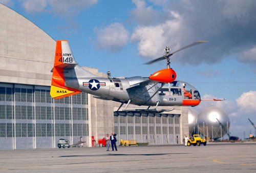

Bell already did something along those lines with the XV-3, although admittedly, the powerplant was in the fuselage, a configuration Boeing also looked at for their original Tilt-Rotor design for LHX.
Interestingly enough, the configuration used in the V-280 is the same one Boeing used for their Model 222 proposal (picture stolen from Stingray's site), Whig lost to Bell's Model 301 for the XV-15 program .
