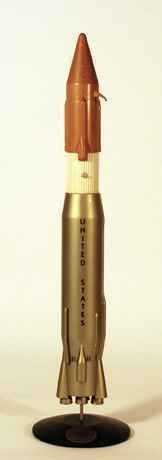

SLV-3X, Atlas Space Launch Vehicle with Centaur Rocket Model found at LiveAuctioneers.
Description:
(22x3") A striking silver, two-piece General Dynamics contractor's model (by Topping) with an orange brown "Centaur" payload on a 6" metal base with descriptive plaque. Minor paint rubs on the base do not detract from this scarce, and seldom seen, model.
http://www.liveauctioneers.com/item/59752

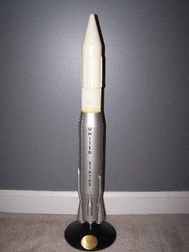

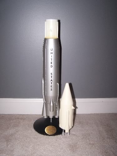

Another image of the SLV-3X model shown above.
http://www.collectspace.com/ubb/Forum16/HTML/000361-2.html
