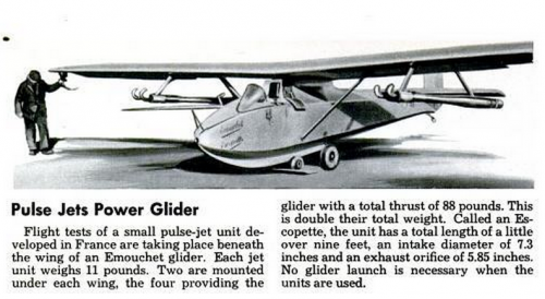

- SA.104 Émouchet Escopette (Blunderbuss) - 1951 ramjet-assisted glider
-- 4 or 6 SNECMA Escopette 60 kgp ramjets (pulso-réacteurs) under wings*

here is the Emouchet with two pulse jet engines.
https://books.google.com.au/books?id=kNwDAAAAMBAJ&pg=PA80&dq=POPULAR+mechanics+May+1952+page&hl=en&sa=X&ei=g1y6VIOIC4fpaLCcgegL&ved=0CCAQ6AEwAQ#v=onepage&q=POPULAR%20mechanics%20May%201952%20page&f=false

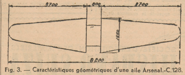

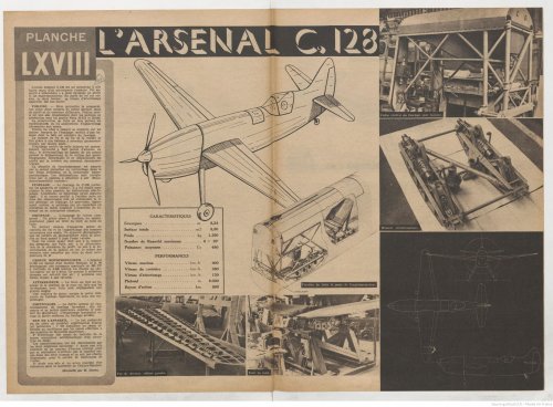

In Decollage 7/1947,
the spoke about Arsenal C.128,I know it was O.101,but what was this designation,
first allocated ?.
first allocated ?.
In an article by French author Philippe Ricco in Air Magazine 52, he says that nobody knows why this plane had two names (C.128 and O.101). But he adds that the C.128 designation seems to have been ephemeral.

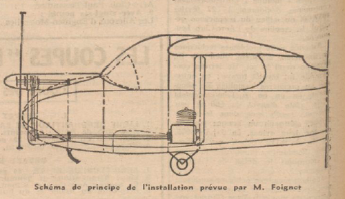

From Ailes 1/12/1951.
