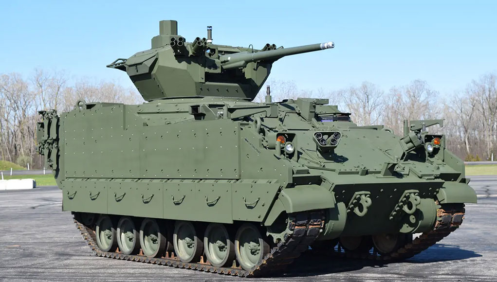

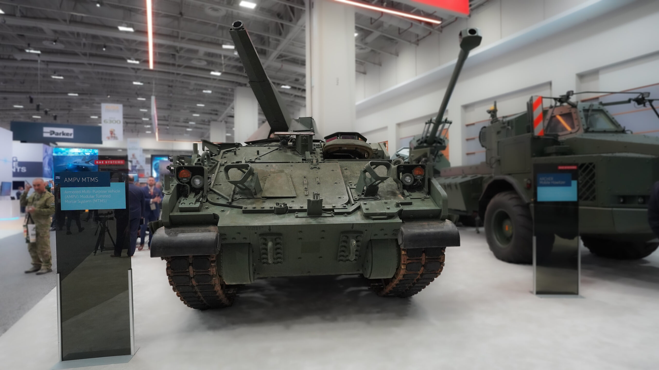

While this is mentioned in a number of other threads, there appears to be no thread dedicated to the Armored Multi-Purpose Vehicle (AMPV) and its developments etc. I will probably transfer a number of the comments posted to other threads to this one over the coming days/weeks.
To begin with, a new development:
BAE Systems unveils new version of AMPV armored vehicle

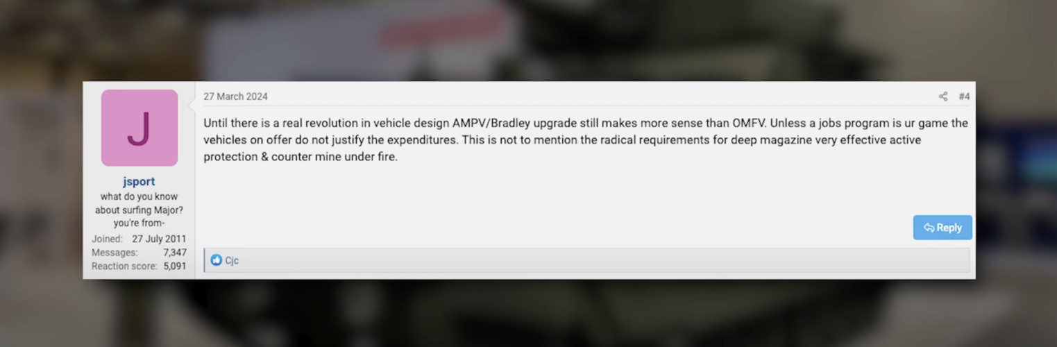

Until there is a real revolution in vehicle design AMPV/Bradley upgrade still makes more sense than OMFV. Unless a jobs program is ur game the vehicles on offer do not justify the expenditures. This is not to mention the radical requirements for deep magazine very effective active protection & counter mine under fire.
