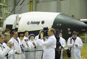

Hmm. Looks familiar
That was—what? A Falcon Heavy to allow reuse of the second stage as a mini-ITS?
The biggest aeroballistic craft—-outside of Biconic Mars craft or MTKVA:
—was this perhaps?
The Falcon Heavy mini-ITS looks more doable…just eyeballing it…more immune to weight-creep than Ariane 6.

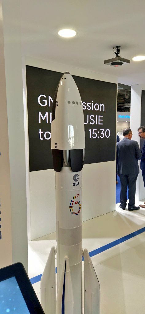

This seems to be an hybrid of
a) a fairing
b) starship
c) hermes
d) a third stage
Nice concept but weird mix.

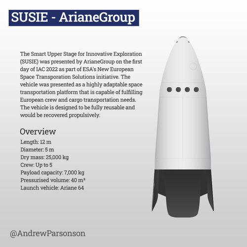

Judging by this image, both it's angle and the TPS, it re-enters by Adama manoeuvre and the flaps allow hypersonic control, opening fully when it's descending tail-first on rockets to land. That builds on experience from the IXV and Space Rider. A rather different layout from the flaps on Starship though.
Susie is radially symmetrical, unlike IX/Space Rider and that's because the latter were/will be launched within aerodynamic shrouds. Putting something that generates lift on the top end of a rocket will cause stress and control problems once it gets up to speed while still in the atmosphere. I wonder how Sierra plans to deal with those with the full-sized manned Dreamchaser?
Got these from the Arianespace website.
Thanks but I have to say those leave me even more confused with what's up with those appearing/disappearing 'secondary flaps' that seem to randomly be place in certain pictures and absent from others. I initially thought they were covers for the landing gear but they don't appear in the landing pictures (nor most of the on-orbit ones) but appear during separation and in the open bay one. (At least I think they do, hard to tell) I mean it would make some sense to have them but on the converse side they would be in the way of the gear (too short) and complicate the reentry aerodynamics. Anyone?
Randy
