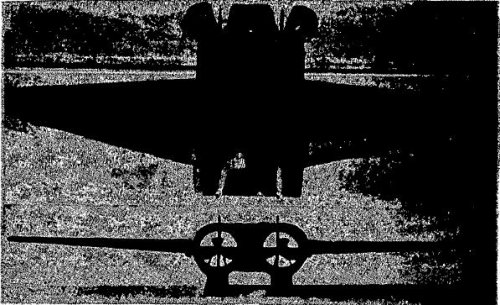

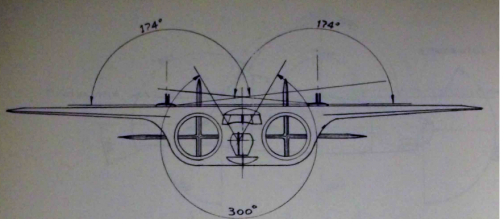

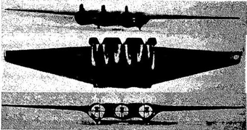

I am not sure whether this drawing belongs to real projects or fantastic illustrations.
Could you help me classify it, please?

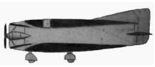

The illustration seems to be related to the Stipa-Caproni airliner projects dated beginning of the 30'S.

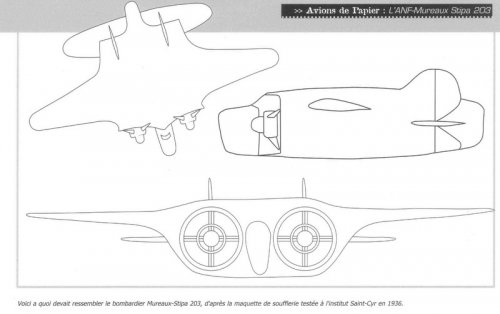

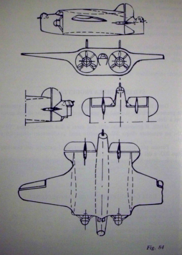

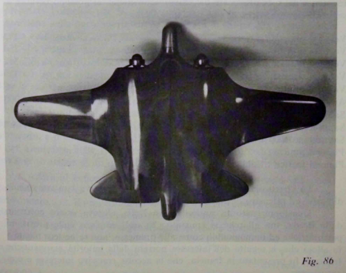

Thanks Lark. For more on the Les Mureaux-Stipa project, see: Model Stories
http://modelarchives.free.fr/Bestiaire/Stipa_P/index.html

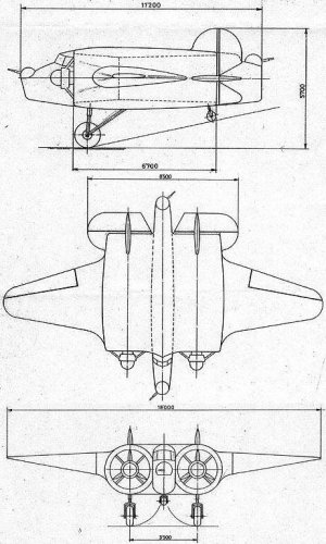

The 3-view was taken from that site. There is also a photo of the wind tunnel model.
I believe the Potez 220 and 230 are projects by Mureaux, but build later by Potez 1939 and 1940.
Thanks Maveric. I keep getting myself confused on the 203 vs 230. :-[
The Potez 220 was the eliptical-winged twin that I was trying to remember. The Potez 221 AB3 project must be a recce bomber development of the 220 (presumably with a glazed nose replacing the 220's ventral observation position).

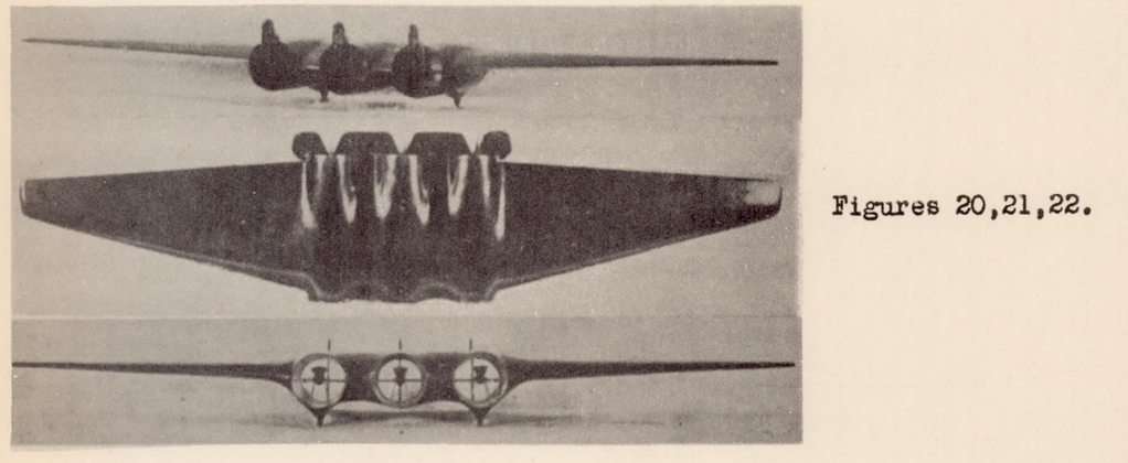

http://ntrs.nasa.gov/archive/nasa/casi.ntrs.nasa.gov/19930094664_1993094664.pdf

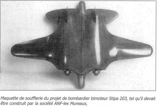

Searching for something different, I'just found two pictures of the ANF Mureaux Stipa 203
in the Aviation Francaise Magazine N°3:
(Split from the thread in the designations section)

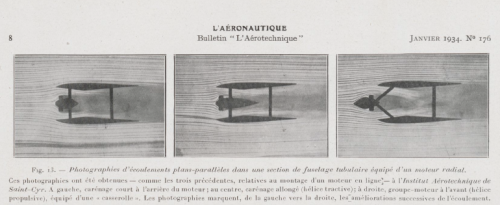

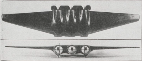

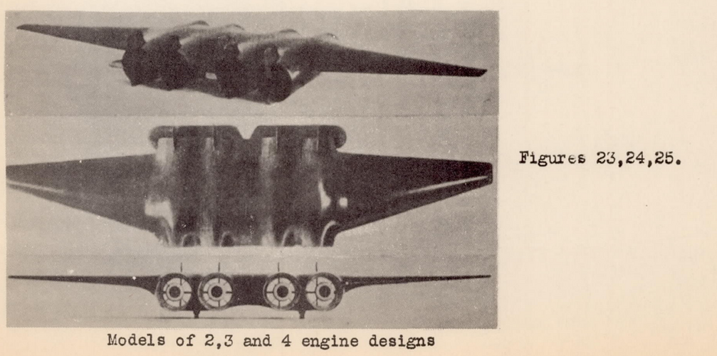

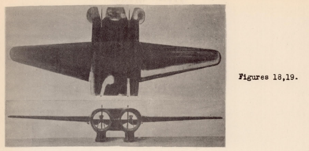

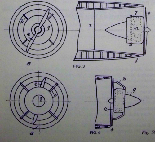

From l'Aeronautique 1934,
here is the Models for Stipa twin and three engined projects,and the flow of the
air in tubular section.

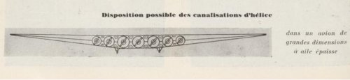

Also from Icaro 12/1932,
they called that Stipa-Caproni 120 ?.

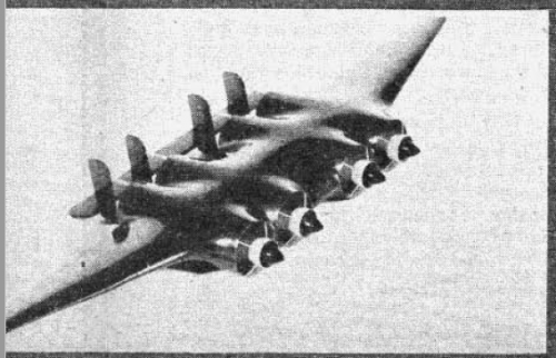

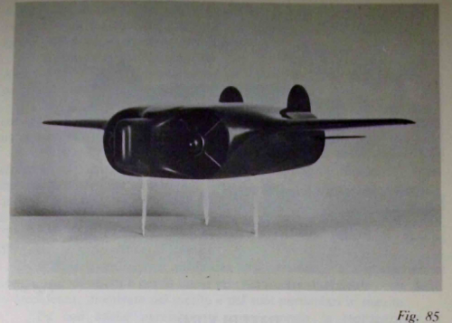

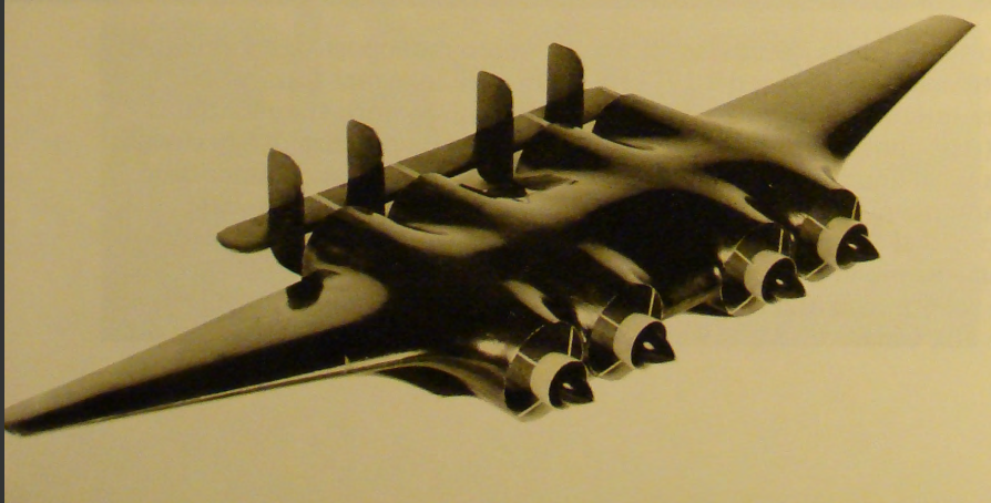

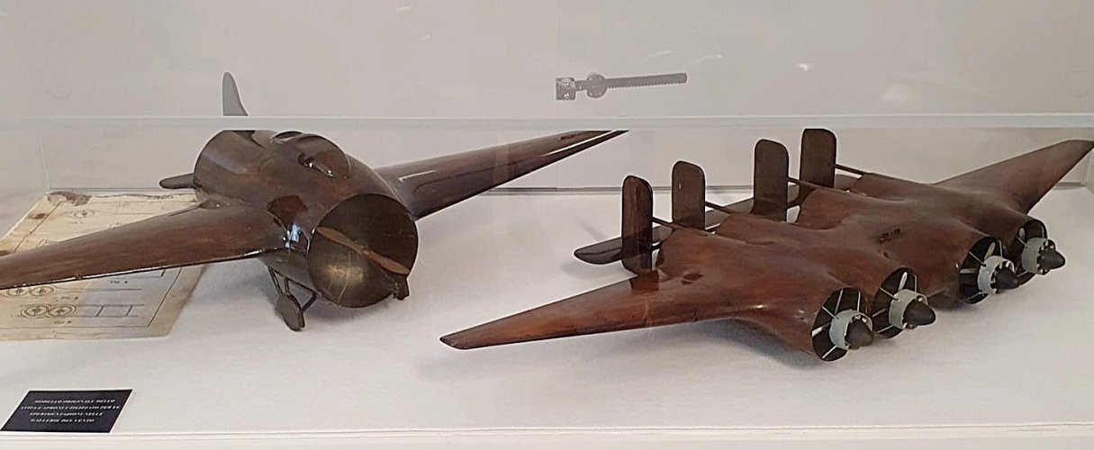

Model in display case at Leonardo da Vinci museum in Milan. Not labelled but likely Caproni. Not obvious in these poor quality images are the elevators and rudders (x3) behind the engine ducts.
Closest I could find https://information2share.files.wordpress.com/2012/05/huge-barrel-plane-for-ocean-flights.jpg
Hi Covert,
it was Caproni Stipa;
http://www.secretprojects.co.uk/forum/index.php/topic,6254.msg235725.html#msg235725
http://www.secretprojects.co.uk/forum/index.php/topic,3423.msg27277.html#msg27277

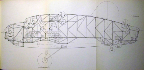

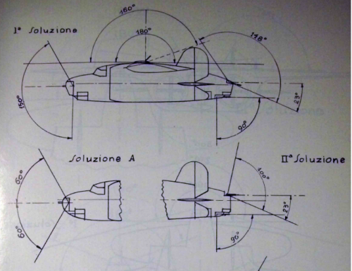

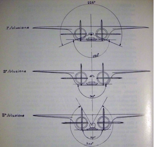

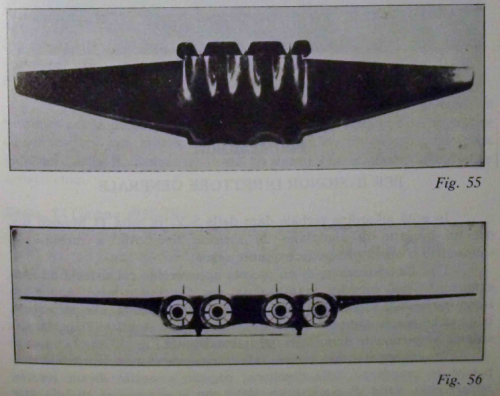

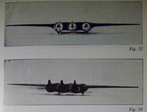

from the report; Volo del 1 Aereo a Jet Stipa

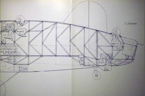

And;

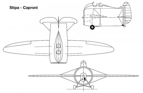

and maybe this Model was early Stipa concept,please note the shape of front and rear
wings are different.
http://www.avia-it.com/act/biblioteca/libri/PDF_Libri_By_AVIA/Almanacco_Aeronautico%20_1932.pdf

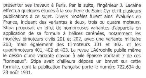

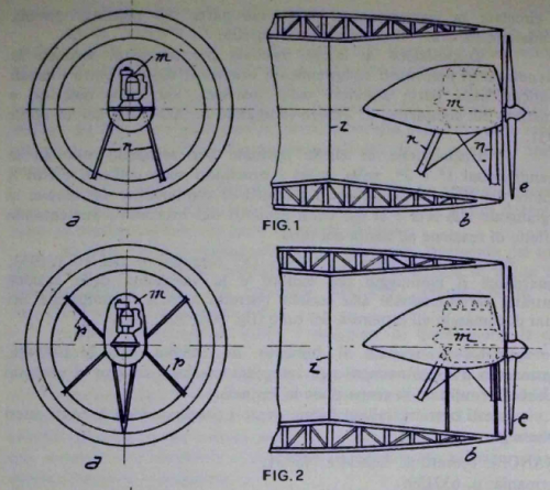

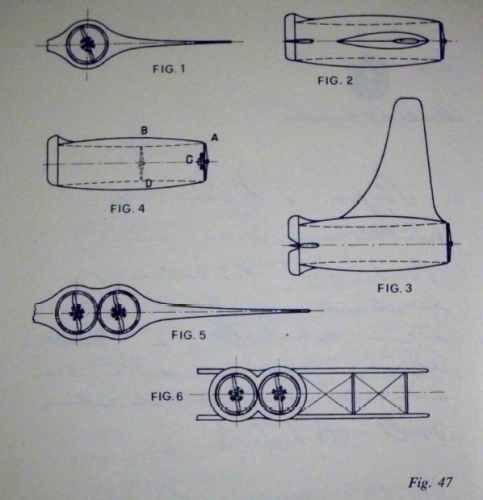

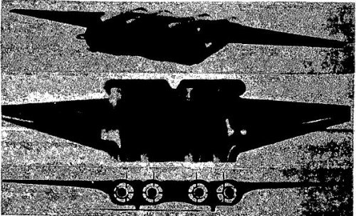

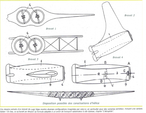

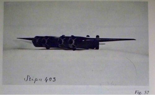

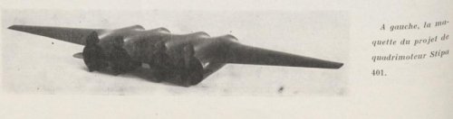

from AFM 03 magazine,here is some patents for Stipa,and its variants,Model-201 & 202 was twin engined
civil aircraft and Model-203 was a twin engined military aircraft,the three engined was Model-301 & 302,
also the four engined was Model-401,402 & 403.

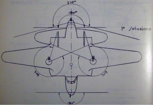

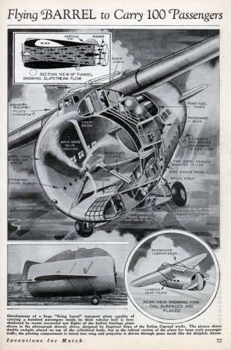

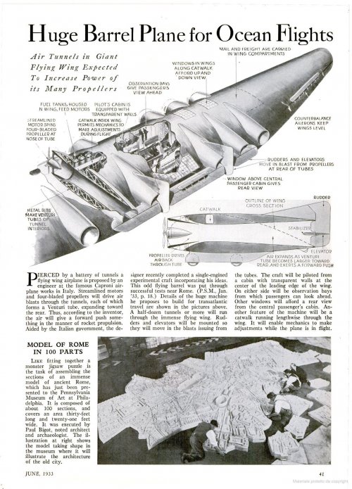

a large version was intended to carry 100-passenger;
http://blog.modernmechanix.com/flying-barrel-to-carry-100-passengers/

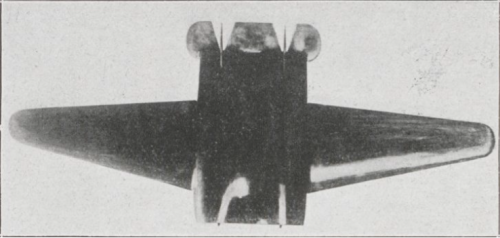

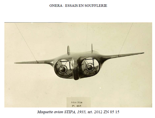

From Onera Archive,
here is A Mureaux/ANF Type-210 Model.

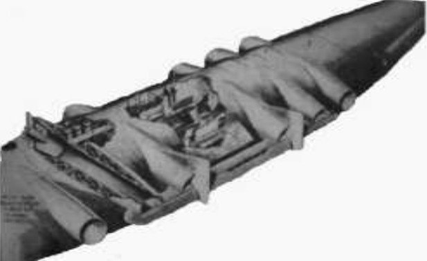

A clearer views.

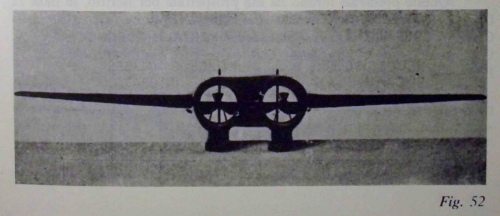

From, Vinello_francese_e_buon_vino_italiano_storia_delle_Botti_Volanti
