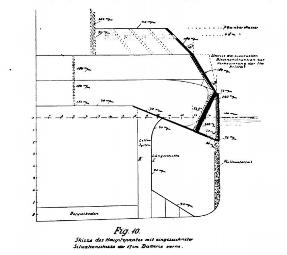

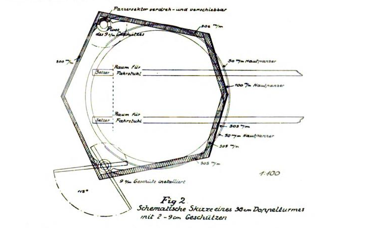

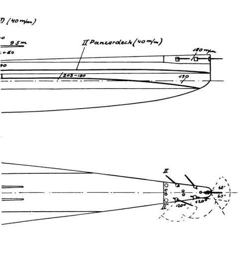

Unfortunately, the general plan was not fully scanned; the University of Michigan holds a copy of this book, and hopefully, the complete version will be available in the future.

That nose section with 5x 88mm guns seems to be quite crowded.
