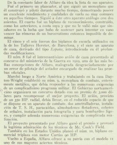

Here is a summary of Alfaro aircraft:
- Alfaro 1, glider
- Alfaro 2, monoplane, 1914
- Alfaro 3, two-seat derivative of the Alfaro 2 (mentioned in Aérea and nowhere else)
- Alfaro 4, observation biplane started by Alfaro and completed by Talleres Hereter, 1917
- Alfaro 5, biplane trainer, certainly corresponds to the Talleres Heterer TH E.2, single-seat copy of the Caudron G.3
- Alfaro 6, biplane trainer, ertainly corresponds to the Talleres Heterer TH E.2, two-seat copy of the Caudron G.3
- Alfaro 7, biplane fighter, derivative of the España (itself an evolution of the Spad VII redesigned by Barrón)
- Alfaro 8, biplane fighter, entered at the 1919 military aircraft competition, was damaged and could not finish the competition
- Alfaro 9, an unidentified Dayton-Wright single-seat all-metal combat airplane with 350hp radial engine, designed by Alfaro in the US
- Alfaro 10, three-seat transport biplane made in the US with Curtiss 90hp engine
- Alfaro 11, single-seat light sesquiplane with Bristol Cherub engine, designed in Spain, whose construction was perhaps not completed
- Alfaro 12, might possibly correspond to the NAS Air King modified by Alvaro as the "City of Peoria", 1927
- Alfaro X-13 or SA-1 (SA = Safety Airplane ?), high-wing monoplane entered c.1928 at the Guggenheim Safe Aircraft Competition, which lasted from 1927 to 1929
- Alfaro PTG-2, glider
- Pitcairn-Alfaro PCA-2-30, autogyro
The main source is the attached extract from the Spanish magazine Aérea, May 1924, complemented by various other sources.

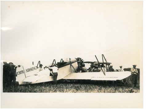

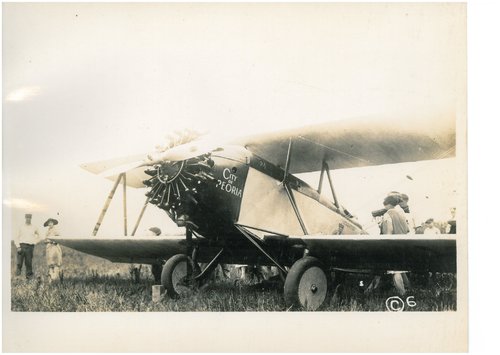

In 1927, Alfaro also made modifications to an ordinary NAS Air King, turning it into the "City of Peoria" participant in the Dole Trophy California-to-Hawaii air race. This possibly corresponds to the Alfaro 12.

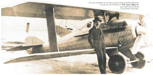

Hi, here it is a picture of the Alfaro 8 Fighter taken from the magazine "Revista Aeroplano" (20/2002) you can download for free in the official page of the Ejercito del Aire at this link
I hope you will like it! :)

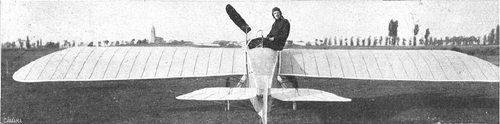

Very strange,
the Alfaro Model-1 was not glider,here;
http://flyingmachines.ru/Site2/Crafts/Craft30173.htm
hesham said:
Very strange,
Hi Hesham,
This is the Alfaro 2, without any doubt. The source of the website is a quiz forum, this is not 100% reliable.
Adrien
Thank you my dear Adrien,and welcome your return.
Hi in looking at various sources of information regarding Heraclio Alfaro I found this one, http://www.aeroclubvitoria.net/en-los-medios/pdf/elcorreo-ala-20171002-010.pdf which I have translated via Google (so apologies for the grammatical errors) for the non-Spanish speaking members. Of note, is that the Alfaro 1 is mentioned as a powered aircraft, which first flew in 1914, much the same timeline as the Alfaro 2. Whether he had two types within the same year, I do not know, but as this above source is from the flying club dedicated to the man himself, it does make me think that this is a good source of what the Alfaro 1 actually was.

In the late spring of 1914 the airplane is finished. It is a torpedo type monoplane, a seven-cylinder engine and 50 HP horses. All the timber was built in the Garayo workshops and the assembly of the engine and other mechanical parts, in Larramendi's garage. On June 7, 1914, the plane it was practically finished and the first tests were done with the landing gear. The final takeoff of Alfaro Fournier's plane took place on Monday 22 June and left about 25,000 people from Vitoria amazed who were able to observe how a noisy wood, metal and canvas artifact —Piloted by a man who he waved his arms - he flew over for more than half hour and at a height greater than 500 meters from the city of Vitoria and
its surroundings. The plane reached speeds of more than 100 kilometers per hour. On June 23 it climbed up to a thousand meters.
The Heraldo Alavés of the 23rd of June 1914 collected an enthusiastic chronicle signed under the pseudonym Champion in which the specialist Ignacio Abreu emphasized that the device devised by Alfaro «is a monoplane, with a stabilization system in inverted tail ». The dimensions of the apparatus were smaller than those of any other airplane of those times. Also original were the landing gear and the way of application of the fuselage to wings, which allowed the pilot more easily handle the plane. Abreu confirms that
«It is the first Spanish apparatus built and the only one that has achieved complete success ».

The first shows the man himself and a design listed as the Alfaro I

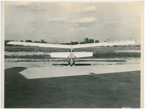

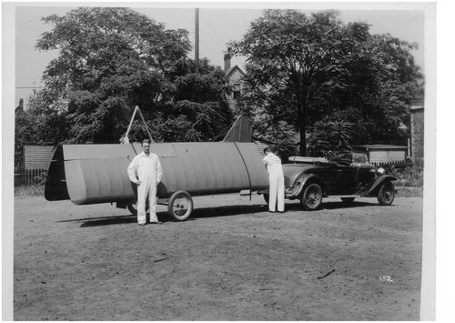

Next up from the US ventures of Heraclio, is the two gliders which he had a hand in. The first was a primary glider, which I would work out must be the PTG-2 from the list that c460 produced in the first post in this subject matter. I also include a shot showing how easy it was to store the design for road transportation.

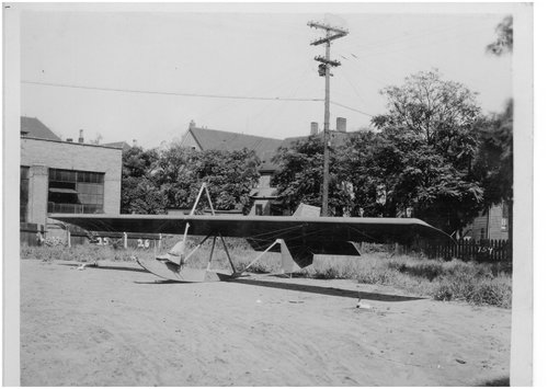

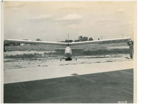

The other glider which does not feature in c460's list is a high wing example, which unusually had a tailwheel undercarriage unlike many other gliders of that period.

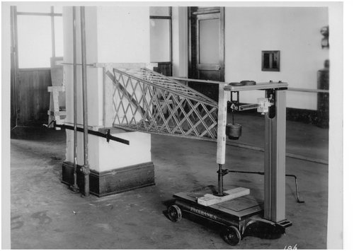

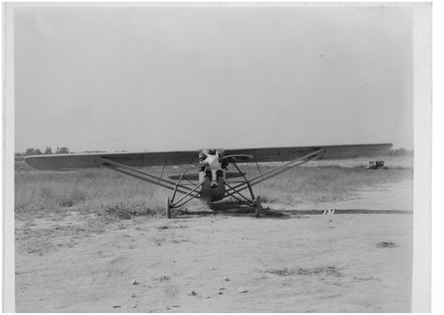

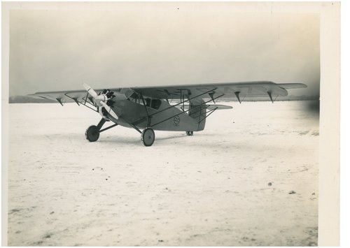

The next example of Alfaro Fournier's US designs was the Guggenheim entry for the 1929 competition, the Alfaro X-13 or SA-1.

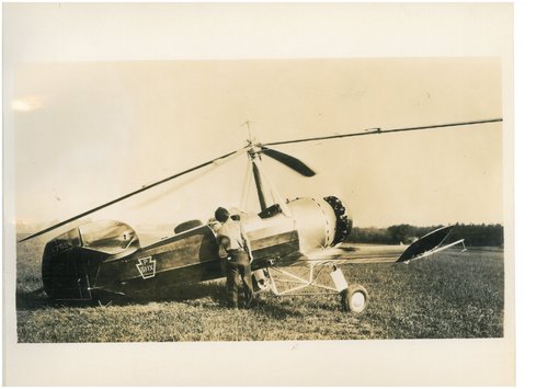

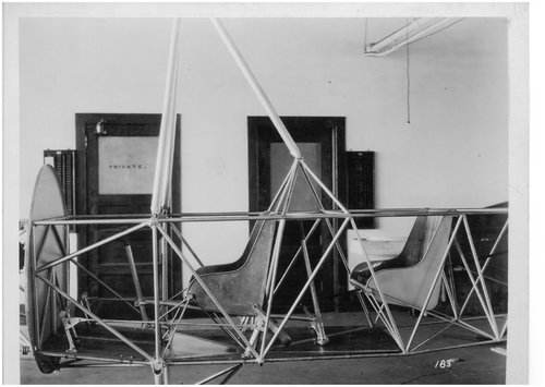

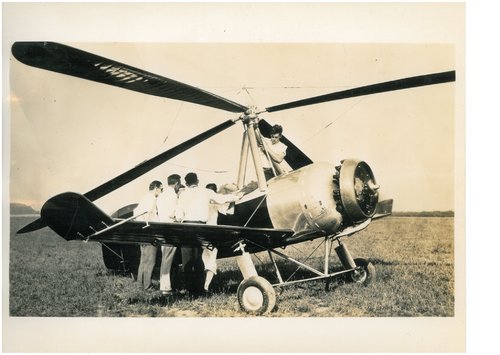

Going to his autogiro, which was based on de la Cierva's plans and built for Harold Pitcairn, here's both construction and the craft fully assembled
5318956741_eaeec5ee0c_k.jpg 5319564586_6b350bbfba_k.jpg 5319546738_5b4289298d_k.jpg 5319552552_7375c0a8d6_k.jpg
Finally the possible Alfaro 12, a modified NAS Air King

Hi Victor, according to the c460's list, the Alfaro I was a glider. But your photo shows a motorized airplane. Is this called the Alfaro II?
