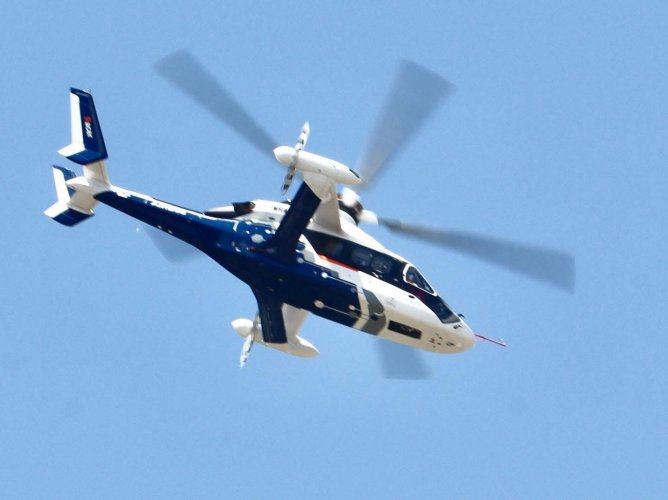

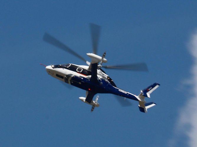

Before & after pics of Racer’s new low drag rotor head and landing gear doors.
Rotor head drag is expected to be 25% lower with these low drag fairings.

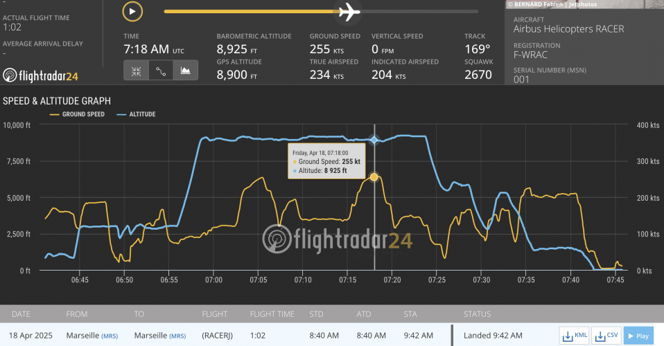

Quick update on Racer testing. 2 test flights in 1 day and 234 knots true air speed achieved. Still waiting for a full level speed test.

13 | 02/04/2025 | 1:03 hrs | 230 knots IAS in dive
14 | 11/04/2025 | 1:16 hrs | 248 knots IAS in dive
15 | 11/04/2025 | 0:41 hrs | 2 test flights in 1 day
16 | 18/04/2024 | 1:02 hrs | 234 knots TAS @ 9,000ft
17 | 22/04/2025 | 0:32 hrs |
18 | 22/04/2025 | 1:08 hrs | 2 test flights in 1 day
19 | 28/04/2025 | 0:42 hrs
20 | 29/04/2025 | 0:45 hrs | 2 test flights in 1 day
21 | 29/04/2025 | 0:29 hrs | 2 test flights in 1 day
