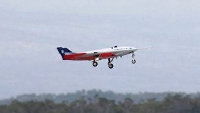

Airbus Defence flew for the first time the Sagitta UAV in South Africa. It's a collaboration project from Airbus and different universities.

The original rendering for this project shows it without vertical fins. Do we know if they will remove them later in the demonstration or have they gone with a "safer" design?
I had thought Sagitta was mainly about tailless flight control demonstration (alongside the other cooperative effort).
