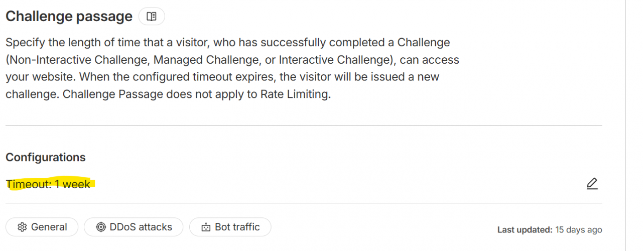

When on a computer you should only get a challenge about once a week.
However I noticed on mobile it was happening more often - this can happen.
If you use a VPN or Mobile private IP where you IP changes often, Cloudflare may consider you sufficiently changed to issue a new challenge. This is to prevent spammers solving the check once then using the same cookie on thousands of different IP addresses.
