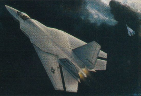

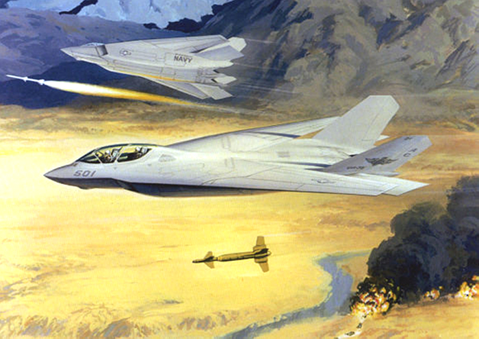

Last I checked all the tooling for the Tomcats had been destroyed in the 1990s, and the remaining aircraft in US Service turned into razor blades and beer cans. With the requirements for stealth you would be starting from scratch anyway. It would look like this:
Or this:
Or any other cool thing Stargazer can come up with if you ask him nicely. ;D Please?

The "upgrade" so far has amounted to a completely new aircraft in the case of an F-18, and a redesign in the case of the Gripen NG. You are welcome to point out other aircraft I may be missing. The F-15SE as of right now is just new CFTs on the same old aircraft. The fact that these aircraft must be "new build" tells me they are not "upgrades"
I believe that if the USN could have their way, their next generation strike fighter would be quite different from the F-35C. Something larger, with two engines, and greater range for a start. Yet due to money, politics, etc. they can't get exactly what they want, so going with JSF and getting the F-35C is the next best thing.
